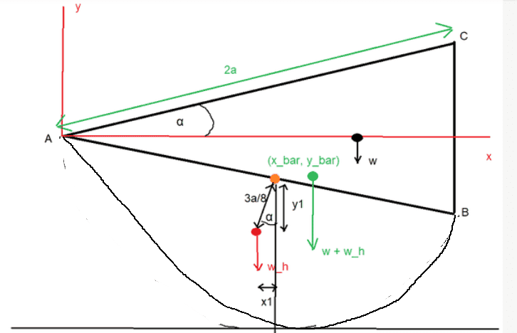

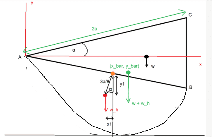

Here's a sketch with BC vertical.
Is the following the best way to go (sorry, preview not working for me so I am not using LaTeX in case I make errors):
Orange dot is midpoint of AB.
A(0,0), B(2a cos(α), -2a sin(α)), C(2a cos(α), 2a sin(α))
x1 = (3a/8)*sin(α)
y1 = (3a/8)*cos(α)
Midpoint of AB is (a cos(α), -a sin(α))
COG of ABC is (4a * cos(α) / 3, 0)
COG of hemisphere is ( a * cos(α) - (3a/8) * sin(α), -a sin(α) - (3a/8) * cos(α) )
Taking moments about (x_bar, y_bar) gives:
((4a/3) * cos(α) - x_bar) * w = -(x_bar - a cos(α) + (3a/8) * sin(α)) * w_h
So this would give w_h in terms of the required patameters if I knew x_bar in those terms.
Well, I could next equate the moment of the composite body about A with that of the sum of the moments of the triangle and hemisphere about A to get another equation for x_bar and them substitute this into the above eqaution. Am doing this but it is long winded, is this unnecessarily complicated, is there a better way? Thanks for any advice,
Thanks,
Mitch.
Let 'P' be the point of contact of the hemisphere with the table.
In equilibrium, the overall CoG (x_bar, y_bar) will be vertically above P. This is not what your diagram shows.
As drawn, the system would be unstable rotate [minor edit made] clockwise. (Do you see why?)

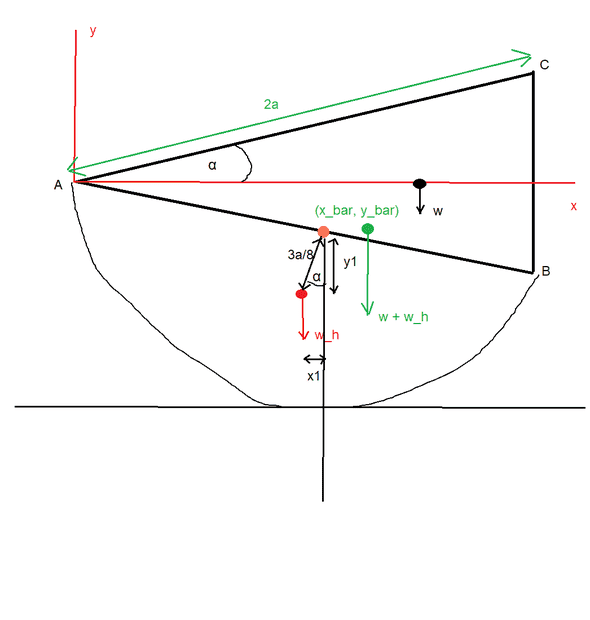

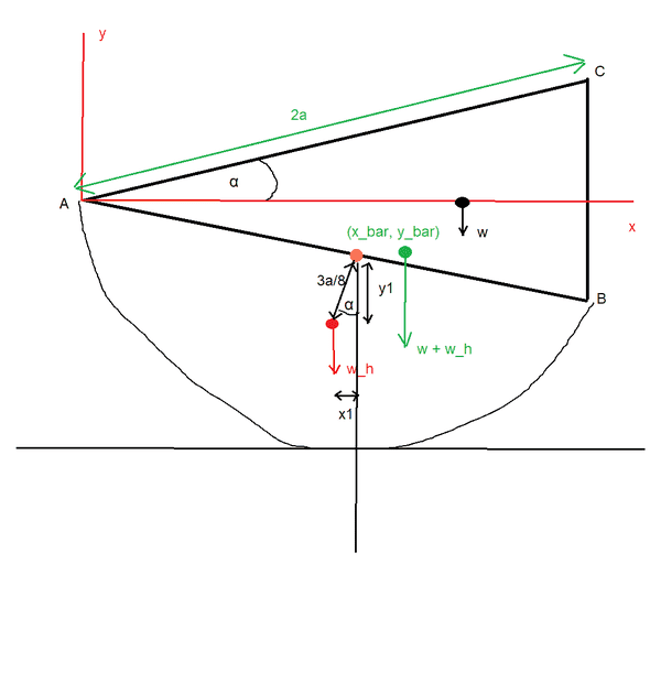

As drawn, the system would be unstable and tipple over clockwise. (Do you see why?)
Yes. I agree that the system as drawn would topple. My poor drawing. The curve of the hemisphere needs to be adjusted so that the contact point is below (x_bar, y_bar).
Here is a rough edit to hint at that:
Despite that unfortunate initial drawing, does my method seem the right way to go, i.e. equating moments about (x_bar, y_bar) and then about A?

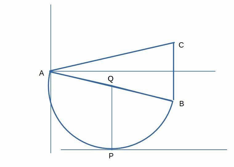

Your general approach is OK but I think that until you get the (misleading/incorrect) diagram sorted out you will not be able to solve this.
Point of contact with table is 'P. Centre of AB is 'Q'.
The overall CoG must be vertically above P (do you know why)? Note that PQ is a radius and the table's surface is a horizontal tangent to this radius.. This means that PQ is vertical. So the overall CoG lies on PQ - which is not what you have drawn.
With reference to Post #9, here's a diagram which should help.
The CoG lies on PQ.
Thanks very much everyone for your help. I see it now. My incorrect diagram sent me off on a much more complicated path. This is a very simple problem which was made into a tough one by my malformed diagram.
Lesson learned (hopefully!) thanks to all the great help,
Mitch.

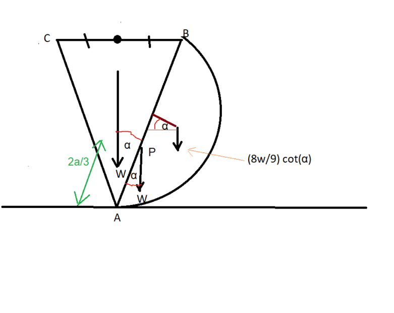

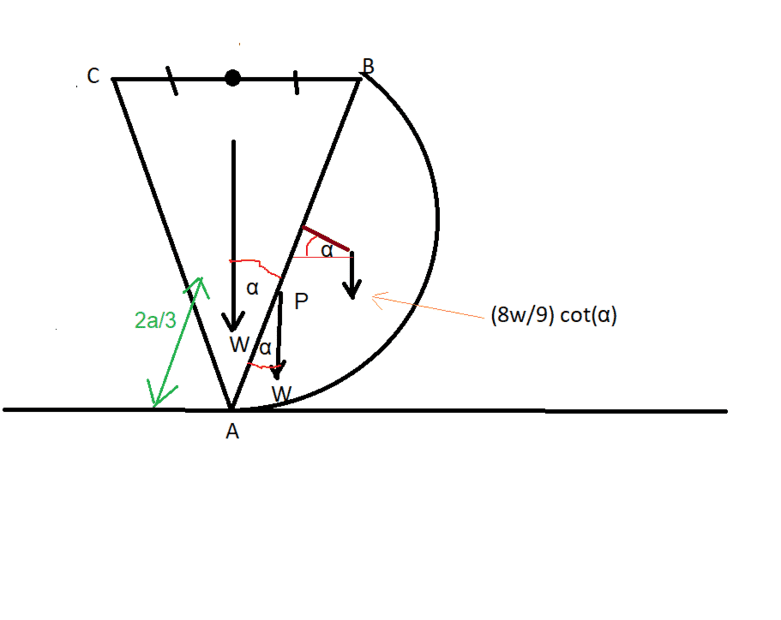

There is a second and final part to this question, and I am confused as to the final diagram, here is the additional question:
A particle of weight W is attached to a point P of AB where AP = (2/3)a and the body now settles in equilibrium with the midpoint of BC vertically above A. Prove that tan (α) = 1/2
So here is my diagram:
Clearly I have misunderstood, as this could not balance on A as I have drawn it as all the weights are to the right of A.
Thanks for any help with the diagram,
Mitch.
Mitch.
It does not say A is touching the ground. It cannot be: the hemisphere will meet AB at a right angle.
Thanks very much. Had trouble visualizing that correctly. I cut out a model to see it! Thanks very much for the help,
Mitch.
