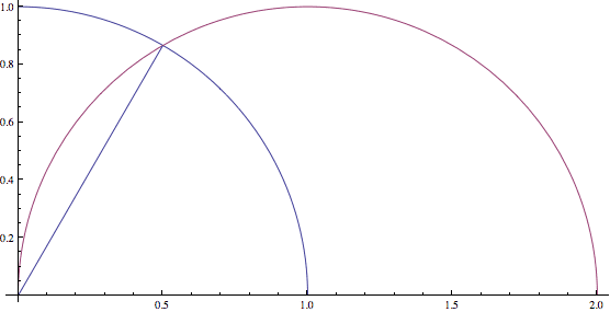

Find the centre of mass of the 2-dimensional plate which occupies the region inside the circle x^2+y^2=2x, but outside x^2+y^2=1, and for which the density is proportional to its distance from the origin.
Centre of mass for x coordinate: 1/m ∫∫ x ρ(x,y) DA
I have already calculated the mass which turned out to be 8/3 by integrating and subtracting the two circle to obtain the area where they intersects. I am now trying to find the centre of mass, the y-coord is 0 as it is symmetrical about the x-axis.
To calculate the centre of mass i am using this domain in polar coord:
1 ≤ r ≤ 2 cos θ and π/6 ≤ θ ≤ 5π/6
With the domain above my equation is:
3/8 ∫∫ x(Kr) r dr dθ
= 3/8 ∫∫ (r cos θ)(Kr) r dr dθ
Is this correct? I was doing the working, i couldn't get any answer because it didn't make much sense to me, and i was sure i am doing something wrong somewhere. Do you guys mind advising me on where i have gone wrong? Thank you very much!

The limits for θ are wrong, but your set-up is otherwise fine.

You're not getting the limits for r correct for the overlap. Try sketching the overlap area and drawing lines for fixed values of θ.
I just sketched the overlapping area, and is the values of θ between π/6 ≤ θ ≤ 5π/6?
No. I've attached a plot of r=1 and r=2 cos θ for 0 ≤ θ ≤ pi/2.
Note that when θ is less than a certain value, r is bounded by 0 and circle 2 in the overlap region. When θ is greater than that value, r is bounded by 0 and circle 1.

Thank you very much vela, okay so i used the coordinates at the intersection points to try and get the angle, and based on what you said above when the angle is between 0 and 60 degrees, r is bounded by 0 and circle 2.
So does that mean if the angle is more than 60 degree, r will be bounded by 0 and circle 1?
Reread what I said in my previous post. :wink:

Okay so i am confused as to which limits of θ i should be using, it will either be π/3 or π/2, but based on the diagram above i should be using -π/3 and π/3 because that angle is bounded where r=0 and r=1.

I find the mass to be
[tex]M = K\left(2\sqrt{3}-\frac{2\pi}{9}\right)[/tex]

Oh, I see what you did. Either you calculate the entire mass of circle 2 and then subtract out the overlap, or you calculate the mass of just the part of circle 2 that doesn't overlap circle 1. You're kind of doing a mixture of the two, which is why things aren't working out.
To get the total mass of circle 2, you need to integrate letting the angle range from -pi/2 to pi/2 and the radius range from 0 to 2 cos θ. Those ranges cover the entire circle. Then you calculate the overlap as we discussed before, and subtract that result from the mass of the entire circle.
If you want to find the mass directly, you want the part of circle 2 that doesn't overlap circle 1. In this case, the angle will run from -pi/3 to pi/3, and r has to go from circle 1 to circle 2. Do you see what you change in your integral to achieve this?
