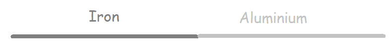

Find the center of mass of a one-meter long rod, made of 50 cm of iron (density ##8g/cm^3##) and 50 cm of aluminum (density ##2.7g/cm^3##).
density = ##\frac{m}{V}##
## r_{cm} = \frac{1}{M} \int \vec r \, dm ##
I feel like I'm missing something fundamental here. Given only the lengths and the densities, how am I supposed to find a numerical centre of mass?Thought process so far:
Are we supposed to use the ratio of the densities to find this answer? like ##\frac{8g/cm^3}{2.7g/cm^3}##? and then use that ratio to pinpoint somewhere in this one-meter long rod?

Is the rod like this?
Assuming same cross-sectional area you do not have to do an integral, just set the origin at the left and place the center of mass for the Iron part and the aluminum part. Treat those centre of masses as point particles. Then use the densitity to figure out a relation between the mass of the iron and the mass of the aluminum
and yes the rod is like that, I think you are thinking the same thing as me when I was talking about finding the ratio between the two densities and pinpointing centre of mass through that, but the other answers have been telling me to do the integral, so perhaps that would be more accurate?

You can answer this conceptually without integrating, just assume that the cross section of the composite bar is uniform.
1. You have a composite bar that is 100 cm long. Pretend that it is a meter stick.
2. The center of mass of the iron part is at the 25 cm mark and the center of mass of the aluminum part is at the 75 cm mark.
3. For every 8.0 g of iron you have 2.7 g of aluminum.
4. Where is the center of mass of two point masses, 8.0 g at 25 cm and 2.7 g at 75 cm?

that makes sense, basically translating it into a problem where there are two numerical points we can use to calculate centre of mass from... I'll try that right now. I'm not sure I understand how to use the integrating method but I can follow this line of thought! thank you all for helping
That line of thought is also using the integral. It just splits it into two parts with constant integrand.
