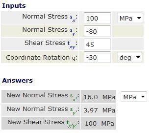

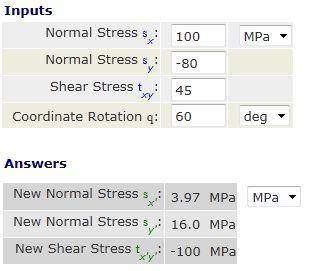

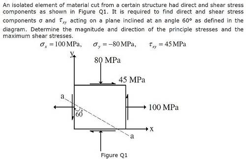

I'm in doubt the angle that I should be using to solve σx' and Tx'y'. Is 60 degree or -30 degree?
Ps: I know how to determine the principal stresses and max shear. Just the angle that I'm in doubt at.

Why is it 60 deg but not -30 deg?
And how you see whether the line a-a is going to be the new x or y-axis?
stpmmaths: A plane is defined by its normal vector. The axis normal to the new plane is always x'. We see +x' is +60 deg from the +x axis. Theta is the angle measured from the +x axis to the +x' axis. The y' axis is parallel to line a-a. The +y' axis is +150 deg from the +x axis.

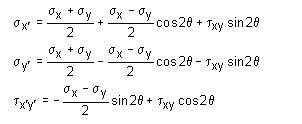

So if the question is
The angle I will be using is 120 or -60 deg, right?
stpmmaths: Yes, 120 deg. Also try -60 deg, and see if it gives the same answer. If it gives the same answer, you can use either 120 deg or -60 deg.

Yup it gives the same answers.
