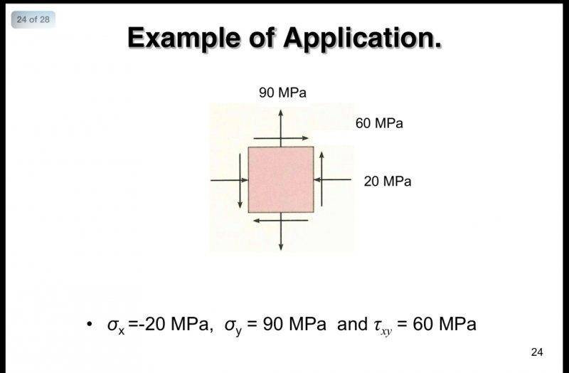

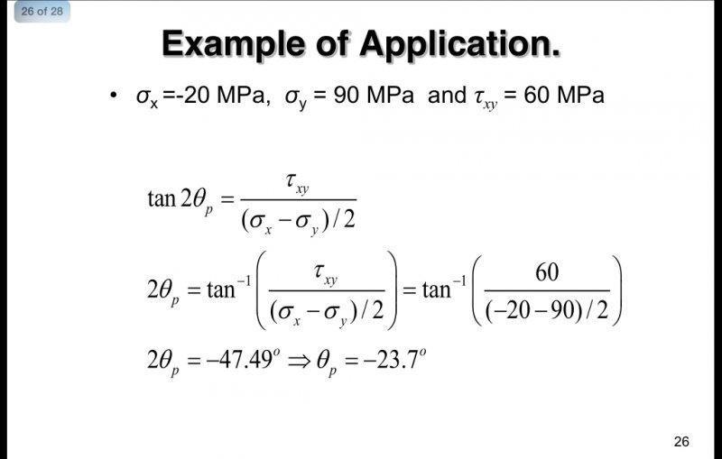

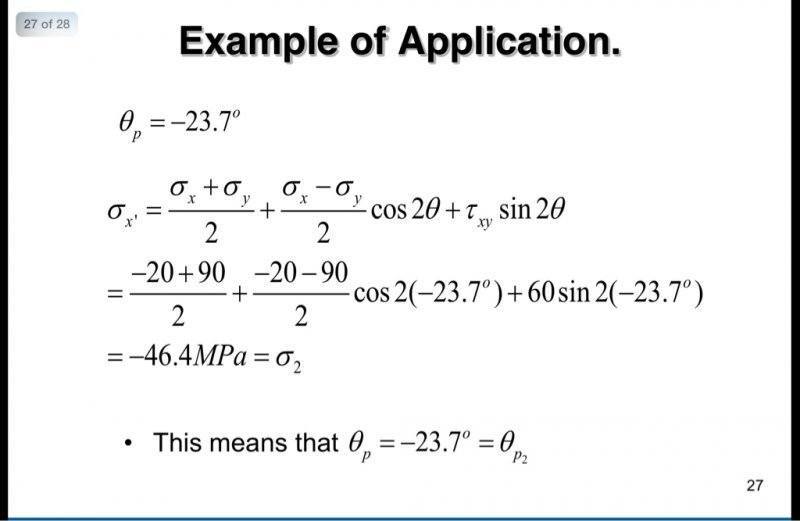

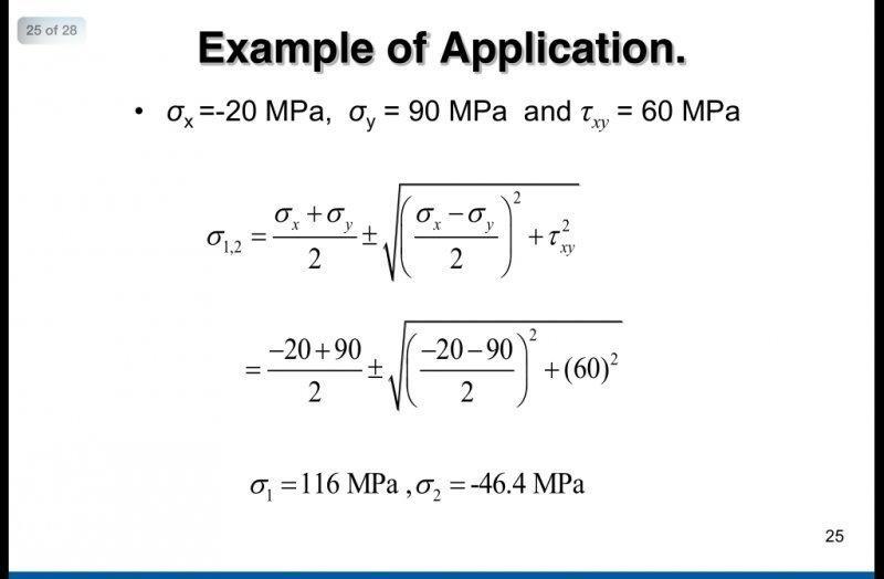

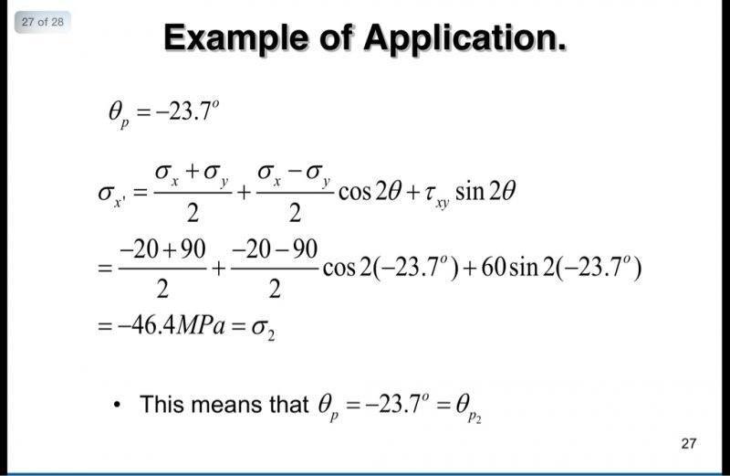

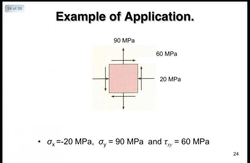

When one substitutes the angle -23.7 into the plane stress transformation equation for SigmaX' you indeed get -46.42 MPa (as shown in the images). However, if you substitute this same angle into the plane stress transformation equation for SigmaY', you yield the other principal stress of 116.4 MPa. My question is how can you conclude the angle -23.7 corresponds to SigmaX' rather than SigmaY' ?
influx said:
View attachment 81981View attachment 81982View attachment 81983View attachment 81984
The angle θ is the angle that you have to rotate the x-axis to get the x' axis.
