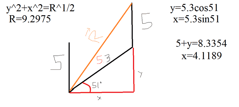

Could you tell me what you did. I closed this problem and a new practice problem appeared but the same concept. I still cannot get the correct direction. I thought it was suppose to be tan^-1(opposite length/adjacent length) to find the angle but it keeps on telling me my answer is off...
i used the resultant triangle and found tan^-1(y/x) but it is incorrect.Edit: they keep saying that my answer is within 10% of the correct answer. It could be my rounding off, but if you tell me the correct way of finding it would help
the magnitude is off a bit because i think of my rounding off.
but please look at my picture and where do i go from there to find the angle of the resultant counterclockwise from the +x axisoops in my picture i put R^1/2, instead it should be ^2
  • Handwritten vector diagram: a 51 degree angle at the origin, a 5 unit vector at the start and a 5 unit vector at the end, with the resultant in orange, and red components x and y, with equations y = 5.3cos51, x = 5.3sin51, and 5+y = 8.3354.
For any vector given in x and y components you should first determine which quadrant of the Cartesian plane the vector lies in. This is done by looking at the signs of the components. A quick sketch on a set of coordinate axes will make it clear.
Then you want to find the angle. How you do this will depend upon which quadrant the vector lies in. Sometimes it will be easier to find the angle with respect to some other axis first, then add or subtract appropriate multiples of 90 degrees to make up the correct offset. It should be clear if you make the sketch.
In the present case, both components of the resultant are positive, so the vector lies in the 1st quadrant. The positive x-axis lies below it, so the angle is simple atan(y/x), where y and x are the vector components. (note: atan(y/x) is the same as tan-1(y/x) ). So you were working correctly.
If the angle you're getting looks incorrect, check to make sure that your calculator is returning angles in degrees rather than radians. It's also best to carry a few extra decimal places for intermediate results. Round final results to the appropriate number of significant figures.
