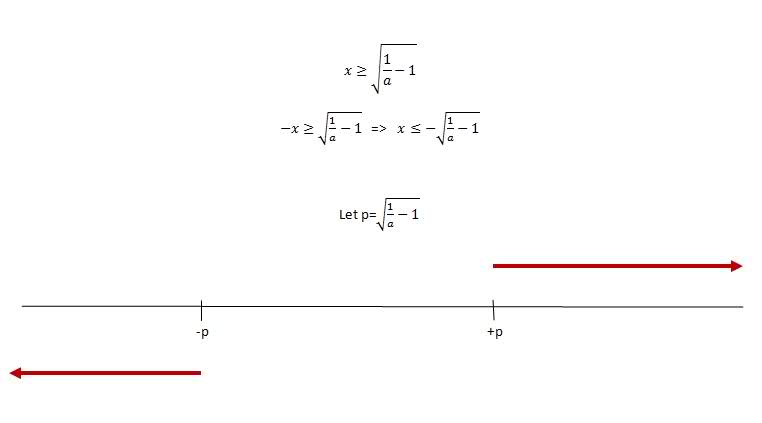

The problem is:
for all 0≤a≤1
so i need to find the domain
N/A
I tried it like this:
yet my solution is wrong,i am not so sure why.
wolfram gives me this;
Here are some problems:
1) In the second step you wrote [itex]\frac{1}{a}[/itex]. This is only well-defined if a is nonzero. So you should look at the case a=0 separately.
2) In the last step you essentially did [itex]x=\sqrt{x^2}[/itex]. This is true only for positive x. Indeed: if x=-1, then [itex]x^2=1[/itex] and [itex]\sqrt{x^2}=-1[/itex]. So you need to look at the case where x is positive and x is negative.

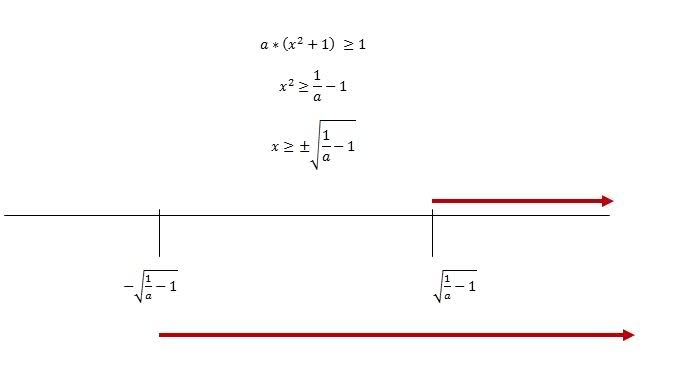

Just to make it simple to solve for now, i am not going to look at case a=0 (only for now)
so i tired to do this:
Again my solution is wrong, i am now covering the entire number line (-inf,+inf), i feel like i am messing up basic algebra. Please help
No, you again did [itex]\sqrt{x^2}=x[/itex]. This is not true!
You need to consider two cases:
1) x is positive.
2) x is negative
And please don't use things like [itex]\pm[/itex], it's confusing. Just taking the square root (which BY DEFINITION is positive) will suffice.

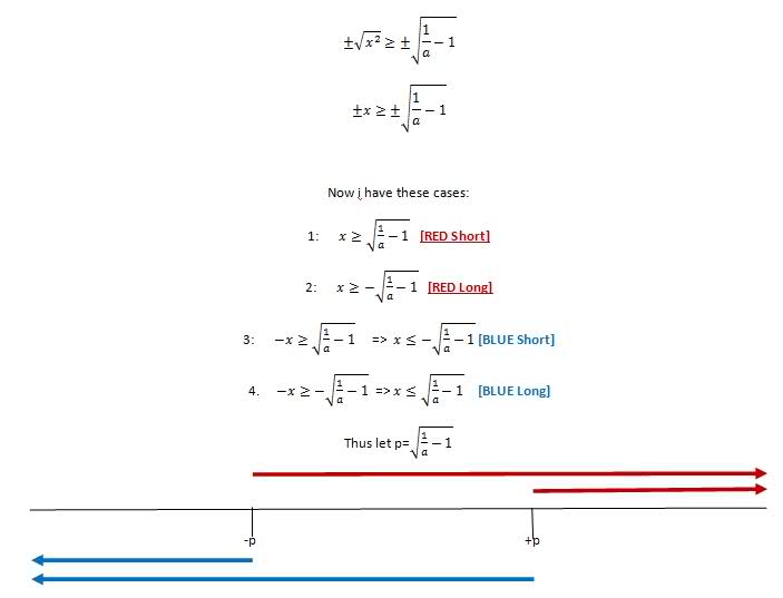

I think i got it now:, Also when i take a square root of a number, isn't that i should take the positive and negative root?. I understand for
Code:
\sqrt{x^2}=x
, because its basically
Code:
 \abs{x}
No. And in fact, taking the negative square root is wrong. Indeed, we have that 4>1, but if we take the negative square root of both sides then we have [itex]-\sqrt{4}>-\sqrt{1}[/itex]. This is the same as -2>-1 which is not true.
So if a and b are positive than a<b implies [itex]\sqrt{a}<\sqrt{b}[/itex], but it doesn't imply that [itex]-\sqrt{a}<-\sqrt{b}[/itex].
