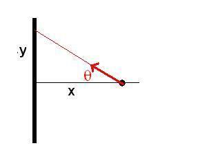

A homogeneous rod with even thickness has mass M and length L.
a) Find the gravitational field g(x) at a distance x from the rod on an axis normal to the midpoint of the rod.
b) Find the gravitational field g(y) at a distance y from the rod's midpoint on an axis through the rod in the direction of its length.
Gravitational potential V(r) = -GM/r (1)
Gravitational field g(r) = -∇V(r) (2)
Where G is the gravitational constant, M is the mass of the relevant object and r is the distance from the object.
a) My plan was to first work out the gravitational potential through integrating the contributions from infinitesimal lengths of the rod (from -L/2 to L/2) and then use equation (2) to find the field. The mass per length of the road is μ = M/L, so an infinitesimal piece of the rod dm = μ dl, where dl is an infinitesimal length. I got dV(r) = -[itex]\frac{G dm}{r}[/itex] = -[itex]\frac{G μ dl}{r}[/itex]. The r is (pythagoras) √(x2 + l2), where l is the distance from the midtpoint of the rod. The problem arises when I try to integrate this function dV(r) = -[itex]\frac{G μ dl}{√(x^2 + l^2)}[/itex] from -L/2 to L/2. Here's when I get in trouble. This integral is a bit hairier than expected, and I find it hard to get a reasonable answer. Could someone point me in the right direction here?
I'll post my attempts at the solution for b) if I can't figure it out after getting help with a).
Thanks,
J

I didn't really check the rest of your work, but if you want to integrate [itex]\frac{G μ dl}{√(x^2 + l^2)}[/itex],
try expressing that as [itex]\frac{\frac{G μ}{l} dl}{√(1 + \frac{x^2}{l^2})}[/itex] then making the substitution [itex]\frac{x}{l} = y[/itex] to get it into a simpler form, then substitute [itex]y = \sinh{u}[/itex].
Tried solving the integral and evaluating it from -L/2 to L/2, but it doesn't look legit. I think my reasoning has failed me at some point while setting up the expression for dV(r). The answer is suppose to be g(x) = -2 [itex]\frac{G M}{L x}[/itex] * [itex]\frac{1}{√(1+(2x/L)^2)}[/itex] i. Suggestions?

I think the integral is easier if you determine the field intensity directly.

jjr said:
Right you are, I was perhaps a bit vague at this point; if I can find the scalar gravitational potential field the grav. vector field is given to be its gradient.
Yes, I noticed it at the end. Try to find the field directly. It leads to an easier integral.
ehild
And calculate with theta, using y=xtan(θ), r=x/cos(θ).
