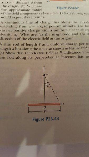

(Taken from Serway and Jewett Chapter 23, Q44, 9th Edition)
A thin rod of length ## l ## and uniform charge per unit length ##λ## lies along the x-axis as shown in the image attached.
(a) Show that the electric field at P, a distance d from the rod along its perpendicular bisector, has no x component and is given by ## E=2k_eλ sinθ_0/d.##
b) What If? Using your result to part (a), show that the field of a rod of infinite length is ##E=2k_eλ/d.##

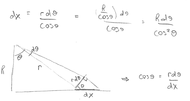

That would be great to see a sketch showing why ##dl= r~dθ/cosθ## is true as I don't know how it is derived.

Here's a quick diagram, hopefully it is clear:
Regarding the factor of 2, it comes from the limits of integration.
Regarding how ##\vec r=l~\hat x + d~\hat y## is derived, it points from where the charges are to the point where you're trying to calculate the field (try drawing it).
