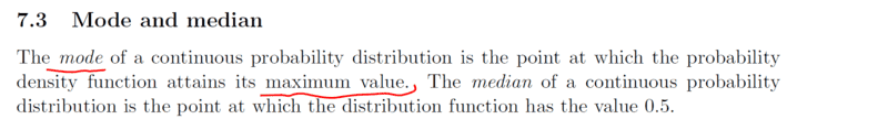

I am just going through the literature on Median and mode of continous data. It is quite clear to me on how to get Median i.e from the Function of the probability distribution and also on how to find the Mode i.e which is the gradient of the probability distribution (in essence the probability density function).
Attached is my reference on the literature.
My question is; ' are there cases where we may have a continuous distribution that has no Mode value? or is it that the Mode will always be there due to the reason that any given function will have a maximum at some point. Cheers.

Also, a PDF need not have a maximum, for example: [tex] f : x \mapsto \begin{cases} 0 & x \leq 0 \\ \frac{1}{2\sqrt{x}} & 0 < x < 1 \\ 0 & x \geq 1 \end{cases}[/tex]

Why would the more of a uniform distribution be 0.5? That doesn’t follow from the definition

I got the definition wrong. I thought (it was a general question) and that uniform equates to the Normal distribution. Wrong!

...here, the pdf
##f_x =\left[- \dfrac{1}{4\sqrt{x^3}}\right]=\left[-\dfrac{1}{4}+\dfrac{1}{0}\right]##
##x## cannot be defined at ##x=0## thus we would not have a maximum point implying no mode.

I think you have confused @chwala: this is not relevant to the definition of the mode. The mode of the normal distribution is 0 because the PDF attains its maximum there.

True i.e for a Normal distribution Mean = Mode = Median=0
