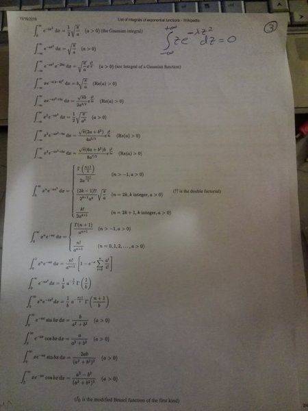

Now see here in this formula list there no formula for x^2 that's why I am stuck at this step needed a hint

Maybe you want to check out number 6 here ?
Otherwise there is CRC handbook of chemistry and physics, or Abramowitz (7.4.6)
so if I use number 6 then can I change limits to 0 to infinity multiplied by 2 then It can be applied ?
one thing more can I change sin(kx) into exponentionals and then try to solve will it work or not??
IF the function is even (##\ f(x) = f(-x)\ ##) then yes.
