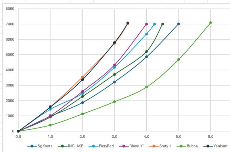

Can't I just plot deflection vs load for a fixed rope to see if it mimics a spring?
B0B said:
Shooting from the hip. If a spring has an elastic limit of 1 kg, 1,000 springs in series would have an elastic limit of 1,000 kg. I'm convinced that kinetic ropes act like springs and if for sure ##F_{MBS}## independent of length rules out a spring, I say it is dependent. WAUG (wild ass unscientific guess).
No, it is still 1 kg.
Yes.

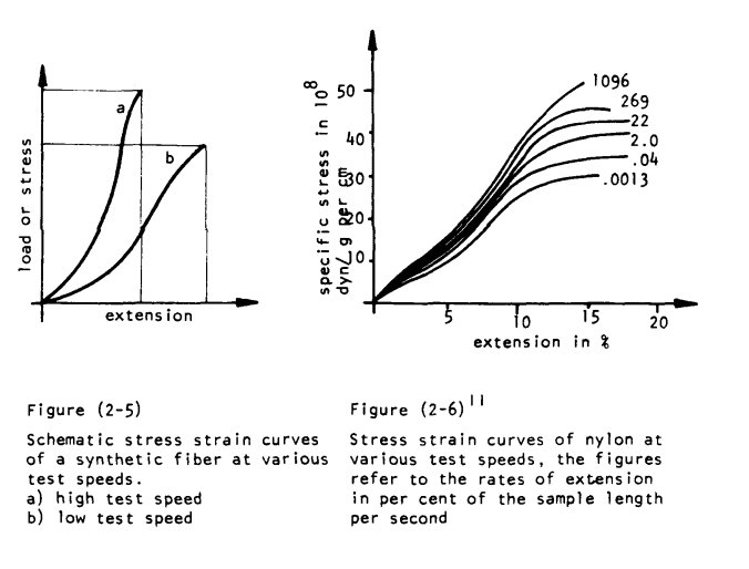

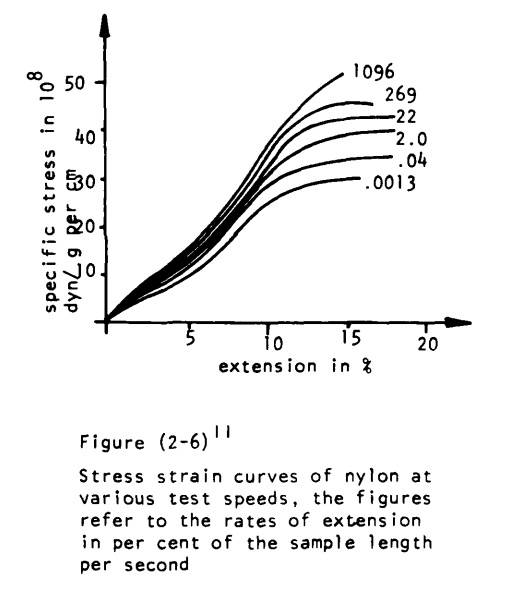

I did a search using terms stress strain nylon rope, and found a document titled Review of Synthetic Fiber Ropes: https://apps.dtic.mil/sti/pdfs/ADA084622.pdf. It has a good discussion of what happens when a rope is subjected to repetitive loadings. That discussion is consistent with the observations of @B0B about ropes breaking after a number of uses. That document is highly suggested reading for anybody who finds this thread interesting.
The following stress strain curves are from that document:
Graph of specific stress in 10^8 dyn/g per cm against extension in percent, with six nylon stress-strain curves labelled 1096, 269, 22, 2.0, .04 and .0013 for different test speeds.
Note that nylon does not have a linear stress strain curve. That means that the linear spring equations, such as ##Energy = 0.5 Kx^2## do not apply. It is necessary to integrate by measuring the area under the stress strain curve.
Since the OP wants to know the energy storage capability of one full length of rope, his best approach is to measure the deflection of a full length of rope. Measuring the strain of a short piece, and using that to calculate the deflection of the entire length, is not only a waste of effort, but also introduces errors. The above plot shows the need for a series of measurements. The resulting data plot would have the horizontal axis in feet and the vertical axis in pounds. It would apply to one specific rope. The results would be directly useful for the energy calculations desired by the OP.

The apparent stress/strain dependency on strain rate is going to be a further complication for the OP’s intentions…

That's super useful. However to a discount engineer or a retired drywall contractor where close enough counts, at high V, linear is a good approximation.
The only way I could measure is with a full rope, but I'm guessing your suggesting that my measurements with a 20' rope cannot be applied to a 30' rope using 2/3*K for the spring constant. I'm also unwilling to apply more than 12K lbs to a rope rated at 43K lbs breaking strength as my current meter requires me to be near the winch line.
EDIT: Update. I've got a portable backup camera I can point at the current meter and then get a safe distance from the ropes under tension. Using a snatch ring to double, I'd probably be OK pulling up to 16K lbs.
Thanks everyone for helping out.

From the cited PDF
Scanned page of printed text with yellow highlighting and a red circle around the label 2-23; highlighted passages discuss elastic and plastic deformation of fibers under fast versus slow loading.
Two side-by-side plots: left, schematic load or stress against extension curves labelled a (high test speed) and b (low test speed); right, specific stress in 10^8 dyn/g against extension in percent for nylon at speeds labelled .0013 to 1096.
I read that as shock loads, aka, high speed loads from a vehicle going 15 MPH yanking on a vehicle in mud is more elastic with better recovery than slow speed loads (aka, my testing approach with a winch). Am I reading that right?
