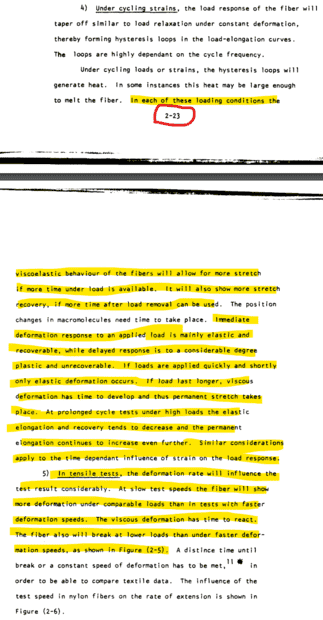

B0B said:
From the cited PDF
I read that as shock loads, aka, high speed loads from a vehicle going 15 MPH yanking on a vehicle in mud is more elastic with better recovery than slow speed loads (aka, my testing approach with a winch). Am I reading that right?
I think it’s says high strain rates are more Hookean in behavior. You should also notice that the forces developed are higher per unit deflection under higher strain rate. What is the initial strain rate for a 30 ft rope at 5 mph, vs 15 mph. How much do the curves change for your rope?
Also, the higher strain rate curves end more abruptly without plastic deformation. So you can get higher loads, but if they snap they are releasing that energy abruptly too. The higher the load the more likely something on the vehicle could fail possibly sending something through a vehicle of the unsuspecting parties involved like in that tragic story you shared.
The question I have is how are you planning to use this info? Ideally you would use it as a type of safety factor, but when that truck doesn’t come out of the mud it could ( not saying you would) be used as a “push the limits factor” instead; which is less desirable for concerns of safety...IMO.

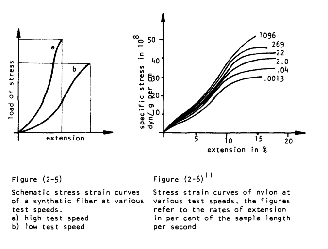

The rope at higher test speeds broke at higher load and less stretch, but there was a large difference in speeds in those tests. Figure 2-6 from that PDF shows the results of strain rates with a range of almost six orders of magnitude. So, let's look at the strain rates of yanking at 15 MPH vs a winch. In order to do that, I make some assumptions. If you have better numbers, then substitute as appropriate.
Assume:
Rope is 30 feet long.
It stretches 15%, or 4.5 feet.
Fast load starts at 15 MPH, or 22 ft/sec.
Slow load (winch) is 1 ft/sec.
Then the strain rates, using the units from Fig 2-6 (percent of sample length per second) are:
Fast: 22/30*100 = 73%/second at the start of pull
Slow: 1/30*100 = 3%/second through the entire pull
Looking at Fig 2-6 with these numbers, there is not much difference between a 15 MPH pull and a winch pull. Note that the pulling vehicle is slowing down while the pulled vehicle is speeding up during the pull, so the rate of stretch decreases during the pull. Does the pulling vehicle ever actually reach that speed by the time the rope gets tight?
I think we want to assume worst case here that the stuck vehicle does not move.

jrmichler said:
Assume:
Yeah, they don't really start to diverge in that range until the region surrounding the onset of plastic deformation it seems. I suppose that is good news, since the goal is to avoid plastic deformation in the first place. Testing for one speed, but having the other in application doesn't appear like it should have dramatic effect.
