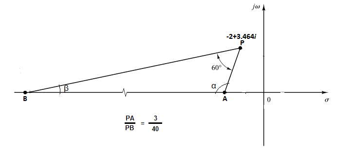

Hello experts,
I have attached the figure below kindly see it. And here is my calculation,
Using law of sine,
from figure we can say that α+β=120°
and β=120°-α
and sin(β)/sin(α)=PA/PB=3/40=0.075
so,
sin(120°-α)=sin(120°)cos(α)-cos(120°)sin(α)
since, sin(β)=sin(120°-α)
so,
sin(β)=sin(120°)cos(α)-cos(120°)sin(α)
dividing both sides by sin(α)
so,
sin(β)/sin(α)=sin(120°)cos(α)/sin(α)-cos(120°)sin(α)/sin(α)
sin(β)/sin(α)=0.866*cos(α)/sin(α)-(-0.5)
3/40=0.866*cot(α)+0.5
0.075=0.866*cot(α)+0.5
-0.425=0.866*cot(α)
cot(α)=-0.425/0.866
cot(α)=-0.49
α=-63.86°
What is this? Why α is -ve? Where I have gone wrong? From figure we can clearly see that it is more than 90°. But calculation says it is -63.86°.
According to the book point A is at -3.70 and B is at -53.35. But I am not getting my angle correct. HElp

What other solutions are there to cot(α)=-0.49?

Nope, I don't see any figure.

Other solutions mean?

Don't you see the figure of triangle?

There's more than one angle in a 360 degree range with a cotangent equal to a given value. For a positive value, there will be one in the first quadrant and one in the third. Here you have a negative value.
No. I don't understand your point of view about more than one angle. Please elaborate with example.

I do now that you have posted the figure.

This figure shows the geometric representation of the cotangent:
http://www.regentsprep.org/regents/math/algtrig/att5/unitcircletriglabel.jpg
This particular figure shows the cotangent for an angle θ which is in the first quadrant. Like its cousin the tangent, cotangent is positive for angles in the first and third quadrants, but negative for angles in the second and fourth quadrants.
You have to figure out how your result relates to your original triangle.

My cot angle is negative because it is in second quadrant. Right?
But look on https://www.physicsforums.com/threads/find-the-value-of-point-a-and-b.845250/#post-5302286 this thread. I worked on it yesterday and it is same question as I posted in this current thread.
In the previous thread, I don't have cot angle to be negative although my triangle is in second quadrant. So why in this current question it is giving me negative value?
You have different triangles.
In the first problem, angle α was less than 90°. In the current problem, angle α is greater than 90°. Don't you think that makes a difference in the value of cot(α)?
Yes, you are right. I have already observed it. But I my calculation is for α so why my α is not correct?
If 180-63.86=116.14
This is greater than 90. And from figure we can see that α is also greater than 90.
If 116.14 is the value for what I am looking for then I don't that understand that why this time I should subtract it from 180. why not in the last question I did this.

I don't think anyone is suggesting that angle α be subtracted from 180°. It's just that your original value of α = -63.86°. What you must do is reconcile this result with the triangle which shows that α > 90°. :wink:
No. I really don't understand.
I have calculated the value of α, then what should be further can I do with it?
And you are true no one suggested me to subtract it. But I don't see any further solution.

What if you added angle α algebraically to 180°? Wouldn't that give you a result which satisfies the triangle? When figuring angles, references are important.

As in your previous exercise, draw the line from P perpendicular to the horizontal axis, and let Q be the point where it intersects the horizontal axis.
You already have ##\cot(\alpha)=-0.49##.
As others have explained, you have two solutions for this, and you obviously need the one in the second quadrant.
So ##\alpha=2.027## (in radians, something like 116°).
In the right triangle APQ:
##|AQ|=\cot(\pi-\alpha)*|PQ|=0.49*3.464=1.7##
So the coordinates of A are ##(-2-1.7,0)=(-3.7,0)##.
Use the triangle BPQ to get the coordinates of B.

One problem still drowning me into the sea of confusion from the starting of this thread is that what does two solutions meant as everybody said and you also said that. I don't get it. Can you elaborate in simple way?

There is not much to elaborate on.
The cotagent is negative in the second and fourth quadrant, so in your case ##\cot(\alpha)=-0.49## implied that ##\alpha=2.027## (close to d116°) or that ##\alpha=-1.11## (close to -63°). By inspection, only the first solution makes sense for you triangle.

In the previous problem we have α=88° and it is positive as it should be in second quadrant. That's why we have not subtracted it from 180° anymore.
But here we have α=-63.853° and it is negative as it should not be in the second quadrant. That's why we have this 180°-63.853°=116.147°(in radians, 2.027rad)
Am I getting it right @Samy_A?

Both angles are mathematically correct solutions of the ##\cot (\alpha)=-0.49## equation. But only the second one makes sense in your specific situation.

I'm glad you are happy with the thread, but I feel you may be not much further forward in being able to solve this sort of question by yourself.
Samy told you what the other solution is, but can you now find all the solutions of f(x)=a for a given value a and given trig function f?
Some simple rules you should know:
##\sin(\alpha)=-\sin(\pi+\alpha)=-\sin(-\alpha)##
##\cos(\alpha)=-\cos(\pi+\alpha)=\cos(-\alpha)##
From those, you should be able to deduce easily ##\tan(\pi+\alpha)##, ##\sin(\pi-\alpha)##, etc.
If in doubt, sketch the curve of the trig function and put a horizontal line through it for the value.
