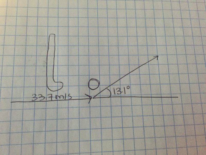

Just prior to impact with a golf ball (0.042 kg), a clubhead (0.195 kg) is traveling with a velocity of 33.7 m/s horizontally towards the target and a vertical velocity of 0 m/s. The coefficient of restitution between the ball and club is 0.79. Impact lasts for 0.00043 s. The launch angle of the ball after impact is 13.1°. During impact the ball behaves as a linear spring with a stiffness of, K= 1182019, and is maximally compressed from its resting state by Δx = 0.01 m.
What is the velocity of the club, towards the target (in the typical horizontal X direction), immediately after impact?

As I posted, the tricky part is specifying the velocities correctly in that equation. This is not a simple head on collision. The ball moves off in a different direction from the club's prior velocity. Precisely what velocities should you plug into the equation?

It depends what you mean by x and y. You are told that the club head is moving horizontally prior to impact. What does the angle of the ball's flight from the impact tell you about the face of the club?
This is what I picture happening when I read the question...
Perhaps the club head is angled? Or the club begins moving upward at an angle of 13.1 degrees before it hits the ball?

It does not move upward. According to the given information it moves horizontally before impact.
Hint: Use conservation of momentum.
