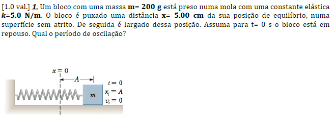

A block with mass m=200g is attached to a spring with a elastic constant of k=5.0 N/m.
The block is pushed at a distance x=5.00cm of its equilibrium position, in a surface with no friction.
Then its dropped of that position. Assume for t=0s that the block is at rest.
What is the maximum velocity of the block?
This is a multiple choice question, solutions being
a) 0.250 m/s
b) 1.25 m/s
c) 0.05 m/s
d) 5.0 m/s
