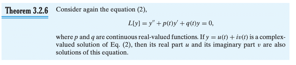

When you solve for the wave function inside the well, it's not so much that you take only the real part of the solution but you choose the arbitrary constants so that the wave function is real.
Likes docnet
Thanks. It turns out I misquoted a theorem I read many months ago. I was supposed to write the real and imaginary parts of the complex valued solution form a fundamental set of solutions to the ODE. I went back to my ODE textbook and found the following theorem that I was trying to remember.
Question: since the Schrödinger equation has a second derivative operator, shouldn't the boundary condition for the wavefunction be that ##\psi## is twice continuously differentiable at the boundary, not just once continuously differentiable?
Classically, if you have a step potential, the momentum of the particle changes abruptly at the boundary. Physically, an infinite force imparts a finite momentum to the particle, and the kinetic energy of the particle is undefined at the boundary. In quantum mechanics, it's similar, so the second derivative of the wave function isn't defined at the boundary.
Note you have a similar situation with the infinite square well. In that problem, you don't even require the first derivative to be continuous at the boundaries because of the infinite potential outside the well. With the finite square well, you've gotten rid of that infinity so you can again require ##\psi'## be continuous, but there's still the remaining infinity in ##V'(x=\pm L)##.
Likes docnet and PeroK
