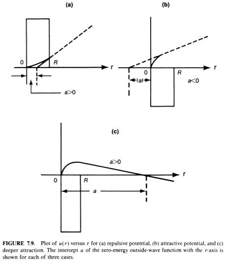

From what I know for scattering, where the problem is slightly different as the spatial coordinate is then radial, ##r \in [0,\infty)##, I expect the following.
The case ##E=V_0## would correspond to a scattering (unbounded) state, increasing linearly outside the well, corresponding to an infinite wavelength. That seems to be what you found. Inside the well, the wave function will be oscillating (the amount of oscillation increasing with the number of bound states).

I agree. In fact, I just worked out a non-normalizable solution. I started asking myself: can the energy of a particle in a free state be equal to V0?
In order to simplify the treatment, I assume we have a stationary flow of particles. Then, since we do not require normalization, a solution to the stationary Schrödinger equation exists. It is a real constant outside the well and a sum of sine and cosine inside (details depend on the selection of the origin). More interestingly, we get the following condition: L*sqrt(2mV_0)/h must be an integer number. Otherwise, the wave-function is zero.
My question is about the interpretation of the solution. For E>V_0, the solution of the problem is a sum of two complex exponentials representing flows in opposite direction of the x axis. Can the same interpretation be applied to our case? Furthermore, it looks like this solution has no classical equivalent. Is that correct?
Are you sure this isn't a degenerate solution? Usually the non-normalisable wave-functions are combined in a wave-packet, with (I assume) the ##E## as the most probable energy. Here, ##E = V_0## is on the lower limit of possible scattering energies, so it ought to have a probability density of zero in any wave-packet.
It a scattering state corresponding to zero momentum, so particles not moving/scattering. What this means exactly I can't say.
As I said above, I don't know how to physically interpret zero-energy scattering. It won't appear in any realistic condition, but it is still part of the set of solutions to the problem, and it used for instance to calculate scattering lengths, as shown in this figure from the Sakurai textbook:

Thanks to both PeroK and DrClaude for the very interesting discussion. Now I understand much better what I found.
I don't think anybody does.
Note that Δp = 0 so Δx must be infinite. I don't know how one would prepare such a state, but it would be hard to describe it as "bound".
Yes, it looks to me like a mix of bound and unbound states. On one hand, the classical corresponding state is bound. On the other hand, it is not normalizable, so it should represent a stream of particles. Also, there is a well-defined condition for it to exist. Not all wells allow such a state. Overall, really strange.
