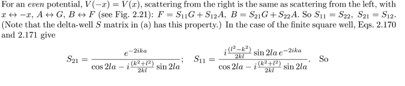

I have gone through the problem in painful detail and a few just like it. I am all for going through things in painful detail, but when the author hints at a more elegant solution, I am all for understanding that too. I just want to understand each step of the more elegant solution provided by the author. I will give you the exact problem and the solution.
Problem: "Construct the S-matrix for the finite square well. This requires no new work, if you carefully exploit the symmetry of the problem."
Here is the S-matrix
https://en.wikipedia.org/wiki/S-matrix
My question is:
Why is the author only considering solutions of the form A <--> G, B <--> F, but not A <--> -G, B <--> -F. There is a theorem in the book that says that even potentials admit even/odd solutions. The statement "Scattering from the left is the same as scattering from the right,..." to me is an acknowledgement that even potential admits even solutions ##\psi##. Again, given above.

What are eqns. 2.170 and 2.171 ?

Grunt work has been done. Like I said. Just want an understanding of the more elegant solution. Knowing equation 2.170 etc does not help you answer my question about the first statement of the solution. What comes afterwards I understand perfectly well.
"It is a matter of taste, but grunt work needs to be done."
I had completed this problem the long way around which involved a lot of calculation and took a long time, re-deriving many of the results in the book but for the case that we have two incoming waves. Like I said. Just want to fully understand the more elegant solution.
