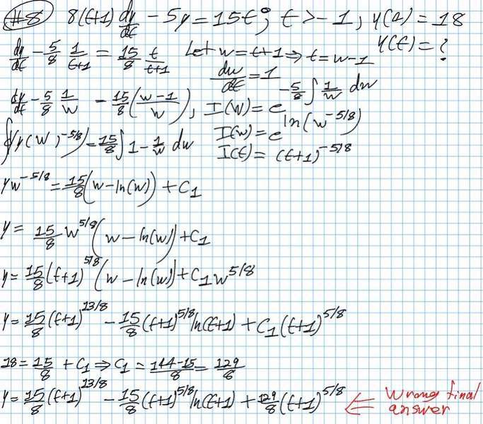

Solve the initial value problem
8(t+1) dy/dt - 5y = 15t,
for t > -1 with y(0) = 18.
First-order linear differential equation.
My latest attempt at a solution is attached as MyWork.jpg.
Any help would be greatly appreciated as always!
Thanks in advance!
Check the second line of your handwriting: An "y" is missing.
