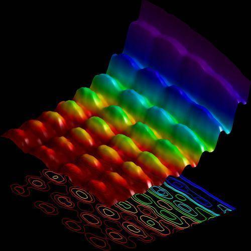

I think this is really neat! Anyone with thoughts about it?
(Phys.org)—Light behaves both as a particle and as a wave. Since the days of Einstein, scientists have been trying to directly observe both of these aspects of light at the same time. Now, scientists at EPFL have succeeded in capturing the first-ever snapshot of this dual behavior.
http://phys.org/news/2015-03-particle.html

In reference to this article:
I don't understand how this is any different than using a photographic emulsion to capture a diffraction pattern. Since my understanding of the photochemical process that reduces Silver Halides requires two photons over a certain decay time to reduce a silver atom in a Silver Halide crystal lattice. Therefore the principle seems to work the same. Any thoughts guys/gals?

As far as I understand, they're looking at a many photon state and they're measuring the semiclassical classical field interaction together with discrete momentum transfer. I don't see how that would allow for their bold claims or in fact be any different from observing the Compton effect while measuring the classical EM field.
So no surprises for me as a theorist. But maybe someone can enlighten me or point me to the experimental aspects that I'm missing.

an experiment with a clever twist: using electrons to image light
How revolutionary! Okay, all eyes and all photographic devices ever evolved/built use electrons...
Fine, they used free electrons, that is not so common.
I do not see anything fundamentally new here. Every diffraction pattern hitting a sufficiently sensitive detector does the same, just with bound electrons instead of free electrons.

The power of marketing: replace
"capturing a photographic emulsion, and deriving a computer-generated image from those results based on mathematical models"
to
"First photograph of light as both a particle and a wave!"
and you become successful. Nobody calls you out on it because few people are confident enough on the subject matter to do so.

Absolutely beautiful.
Now this pic in primary schools.
http://www.nature.com/ncomms/2015/150302/ncomms7407/full/ncomms7407.html
Simultaneous observation of the quantization and the interference pattern of a plasmonic near-field
L Piazza, T.T.A. Lummen, E Quiñonez, Y Murooka, B.W. Reed,B Barwick & F Carbone
Nature Communications 6, 6407
Surface plasmon polaritons can confine electromagnetic fields in subwavelength spaces and are of interest for photonics, optical data storage devices and biosensing applications. In analogy to photons, they exhibit wave–particle duality, whose different aspects have recently been observed in separate tailored experiments. Here we demonstrate the ability of ultrafast transmission electron microscopy to simultaneously image both the spatial interference and the quantization of such confined plasmonic fields. Our experiments are accomplished by spatiotemporally overlapping electron and light pulses on a single nanowire suspended on a graphene film. The resulting energy exchange between single electrons and the quanta of the photoinduced near-field is imaged synchronously with its spatial interference pattern. This methodology enables the control and visualization of plasmonic fields at the nanoscale, providing a promising tool for understanding the fundamental properties of confined electromagnetic fields and the development of advanced photonic circuits.

Hi this pic looks cool, but I am still learning high school physics and very curious to learn. Can anyone elaborate the pic please?
How is that pic taken?
What are those bulges which looks like waves?
How is this pic showing both particle as well as wave nature simultaneously? (Means how I can see both natures in these pic)
Sorry if I am poking my nose in the experts thread:nb)
Thank you in advance.

me nether, still first year college. ... the evidences of light as a wave-particle are explained by refraction or reflection of light into a medium. also light has the property almost of the electron, that's why scientist use electron to identify if light has particle property, if light is not a particle there would be no effect. by proving the wave property of light, scientist provide a thin slit where light can pass, so that light will be as a thin sheet of ray and it form diffraction phenomenon and is describe as the interference of wave according to Huygens Fresnel principle. as you can see on the image, the blue part rises, this is because there is an encounter between light and electron, if two balls hit each other there will be a change of direction, depending on the forces of each ball. hope my explanation helps... well the color tells the us the energy...

As I see it I am not an expert also. It is just like you through rock in the pond. So you see the waves it produce it.
