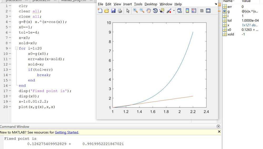

I used the same code , but changing the equation ( line 4). In part (D) , I got a complex number , does it mean that the function is divergence ?
Here's my code :

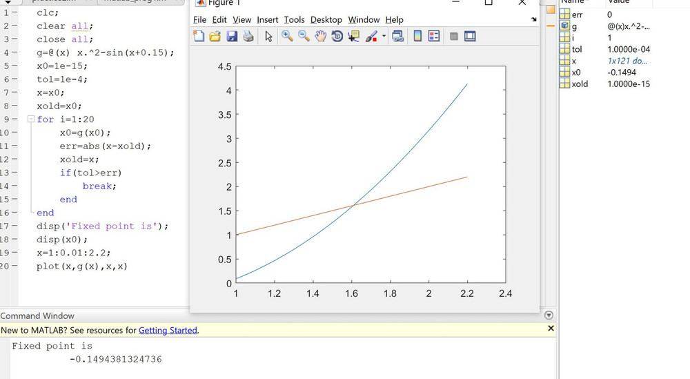

Part c :
MATLAB editor and figure window: code defines g(x) = x.^2 - sin(x+0.15) and runs a fixed-point loop, with a plot of g(x) (blue curve) and the line y = x (orange) over x from 1 to 2.2.
Part d :
MATLAB screenshot: script code beside a figure window plotting g(x) = x.^(x-cos(x)) and the line y = x over 1 to 2.2, with the curves diverging after about x = 1.3; command window shows a complex fixed point result.

x0=g(x0)
How can your program work at all ? Or don't I understand Matlab ?
C)
Did you check with the plot ? where is g(x) = x ? Not at 1.75 !
D)
1^anything = 1 so how come that solution is not found ?
BvU said:
Matlab:
x0=g(x0)
C)
D)
I set the initial conditions ( Lines : 4 - 8 ). The fixed point iteration in part C is x0=g(x0) and to compute the error ,we have to find the absolute value of the difference between x and xold. Once we have computed the error, the current value of x is stored in xold. x(1) is g(x0) when i =1 , x2 is g(x1) when i =2 , and so on ...
Does x0 = g(x0) change the value of x ?
No, I think I have to write x instead of x0 in line 10 ,so x is varying in each iteration. Therefore , the error will be changed as well. Am I right now ?

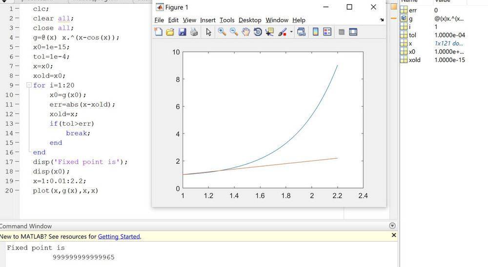

I wrote the same code but changing the initial value of x0 , from ##-1## to ##1e-15## . Here's what I got :
Partc
MATLAB screenshot with code beside a plot window of y = x^2 - sin(x + 0.15) curve in blue and y = x in orange over x from 1 to 2.2, crossing near x = 1.6.
Part d
MATLAB editor, Figure 1 plot, and Command Window: plot of g(x) = x^(x-cos(x)) (blue, rising steeply) and y = x (orange line) for x from 1 to 2.2; Command Window shows 'Fixed point is' with value 999999999999965.
Okay I see another thing (what others clearly noticed before me)... I was so concentrated on the function itself, but you do have another ##x## you're comparing ##x0## to when you check for your error; you're also plotting with respect to ##x##, which your code does not update. Make sure the ##x## and ##x0## is consistent.

Did a little more digging. I think those last two are suppose to be difficult on purpose :) (difficult as in it won't converge easily) but it was fun to explore. That starting value really matters a lot for those two.
If I were to look at (roughly) ##x^2 - sin(x)## and I knew that ##x## was a really tiny magnitude ie. ##|x| << 1##... breaking it up into two parts I would know that ##x^2## is super tiny might be possible to neglect it and ##sin(x)## would be almost itself. If ##x## is large, then the sinusoidal is negligible and somehow ##x = x^2##. Good luck.
Plot of g(x) against idx from 0 to 50: a blue oscillating sequence that grows in amplitude then settles between about -0.35 and 0.33, with a red error magnitude curve on a log right axis falling from about 0.5 to 0.01.
Part d was really interesting. I should have looked at the formula... if you start with a tiny number like I suggested then it makes sense... ##x## is some small number to the power ##x-cos(x)## (probably a negative number), which makes it something like ##1 \over x^\text{small number}##. Of course it'll become ginormous just as we saw. Our trick for part c doesn't work here.
