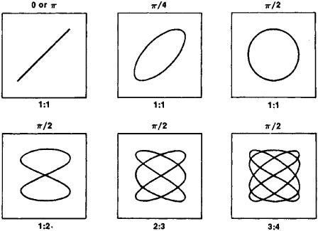

Those old scopes are such fun. I love putting left audio on X, right audio on Y and a phase shift network to make the lows appear circular. (used to drive TV deflection coils that way too with surplus servo amps)
I always liked the lissajous figures:
