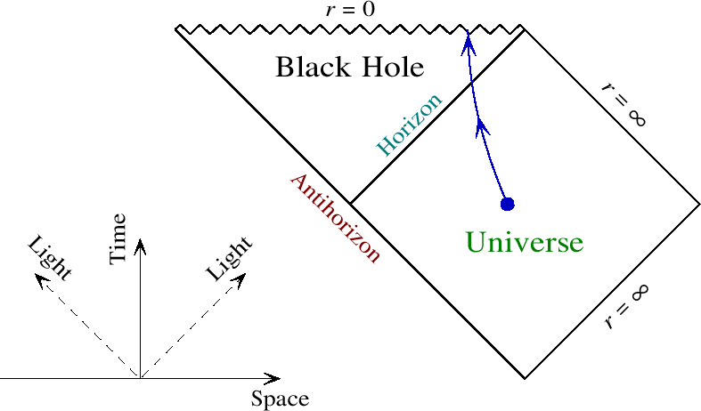

Lets say I fall into a super-massive black hole's event horizon. Facing outwards towards the event horizon (with the singularity directly at my back), turn on my flashlight.
Will those photons emitted by my flashlight actually be able get any further away from the singularity than I was, when I turned it on?
Does the answer change if I ask if they get any closer to the event horizon?
What if I'm shooting bullets from a gun, rather than photons from a flashlight?

Think of the singularity as a moment in time rather than a position in space. If you are inside the event horizon then the singularity is a time in your future.
If you do that, then you realize that your question is similar to the following: "Will those photons emitted by my flashlight actually be able to get any further away from Friday than I was, when I turned it on?""

Some belated info that might help:
The easiest way to understand the geometry of a black hole is a penrose diagram. I assume we are talking about the idealized Schwarzschild interior geometry, there is some debate over what the actual geoemtry of a real gravitational collapse will be.
A penrose diagram of the black hole part of the Schwarzschild geometry can be found at http://casa.colorado.edu/~ajsh/kitp06/penrose_Schw.html
For complete disclosure, I'll mention that I'm not going to talk about the white hole part of the geometry because I don't think it's relevant to the OP's question. If I am wrong, the OP can ask about that I guess, but I think there is enough to cover just dealing with the back hole part.
As the labelling shows, time goes consistently up the page, and light cones travel at 45 angles. Recall from special relativity (hopefully!) that light moves at a constant velocity relative to all observers, so that what is lightlike to one observer is lightlike to all.
Note that the event horizon on this diagram is not a place, it is lightlike. This is probably the most confusing aspect of black holes, it is almost irresitible to think of the event horizon as a place. But the event horizon is intrinsically light like, and thinking of it that way makes it much easier to understand the geometry.
In particular, when the event horizon passes you at "c", because of special relativity, you have no way of ever catching up to it - whether you fire a light beam, or whether you fire a bullet.
You can also see from the diagram that any light or bullet in the future light cone of an observer past the event horizon must strike the jagged line at the top, which represents the singularity at r=0.
Confusingly, the singularity is actually a space-like surface, as others have mentioned.
Bullets and lightbeams will strike the singularity at r=0, the jagged line at the top of the diagram, at different places than the infalling observer (I won't sketch them out, I'll assume, perhaps incorrectly, that the OP can figure out the penrose diagram enough to sketch their trajectories for himself). But they will all strike the singularity, there is no avoiding it.
It turns out that there is a way to maximize the amount of time it takes to reach the singularity, this is mentioned in:

The Penrose diagram makes some things clear, but is messing me up on a couple of points.
-If I start free fall 5 light years away from a tiny black hole, it looks like I will hit the event horizon in less than 5 years!
-Why is the singularity line drawn jagged? (as opposed to curved, angled or straight)

That graph is really great, and does indeed make it easy to see stuff. It looks to me like the two sides of a light cone emitted inside the event horizon will require different distances to reach the singularity! Doesn't this imply direction DOES matter?
I'm afraid I still don't quite understand what this means I will perceive (other than the very well explained tidal forces). In particular I'm still thrown off by the fact that hovering outside the event horizon, I can point with my plumb-bob and say, in that direction is (or will be at some point in time) the singularity location in space [I could even triangulate with Bob and Chuck]. If I letup on the rockets enough to drop through the event horizon, what does the change of geometry actually mean to my plum-bob setup? How will it ever cease pointing in the direction of where the singularity will be?
