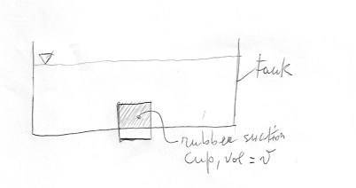

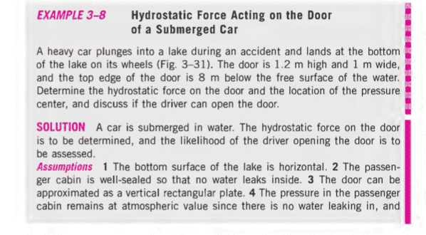

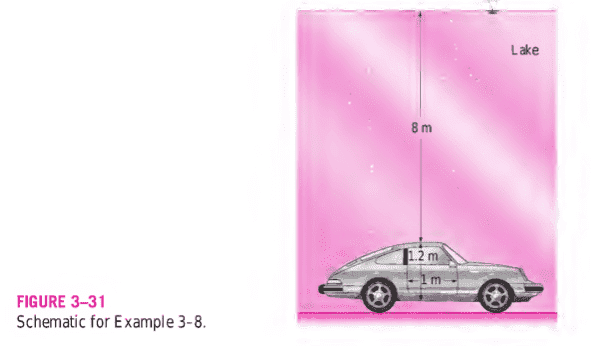

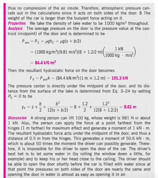

The Archimede ‘ s law keeps its validity for a ship even in a narrow dock, with a small gap between side and bottom plating, and the corresponding dock walls and bottom. Also when the ship is navigating in open sea, and one ignores resistance to motion, essentially due to viscous forces and other causes, such as shape-resistance and waves-making forces, it is valid.
But , if one considers particular situations, some problems arise. I’ll explain what i’m referring to. Suppose a ship is to be pulled in a narrow canal, where side and bottom gaps are small, compared with the ship’s breadth and draft. A very simple application of the continuity equation tells us that the water speed, around the ship, must increase; one can carefully equilibrate the forces that pull forward (f.i. exerted by tugs) or by ground ropes. But a problem arises at the bottom, because there is shallow water: a simple thought to the Bernoulli theorem tells that the increase in speed is accompanied by a decrease of pressure. So the bottom of the ship can hit the canal’s bottom very hardly , and this, together with pulling, causes a series of indents and severe damages to the bottom plating.
This isn’t a joke, in the past the problem arised a lot of times, and I’ve repaired many ships, damaged that way.
