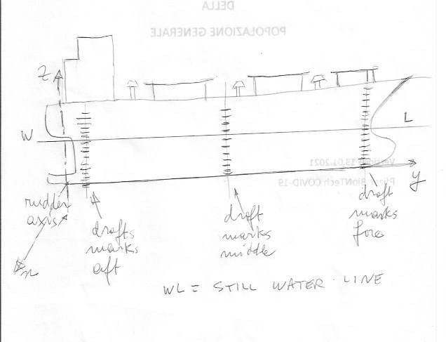

Maybe you don’t know that, in compliance with Classification Societies rules ( consider f. i. the American Bureau of Shipping) , all ships, not only cruise ships, are to be put in dry dock periodically, for inspection , cleaning, painting and repairing purposes.
what is a dry dock? Well, in short, it is a kind of parallelepiped space, in free communicaation with the sea, in a shipyard, where the ship is carefully carried inside by means of tugs and ropes…and other technical facilities . When the ship is completely inside, still freefloating, a watertight door is put in place at the entrance of the dock, and some powerful pumps start pumping out the water left inside the dock, so the ship slowly goes down, until the bottom rests on a series of very robust wooden blocks, which all toghether react to the ship ‘s weight! All the water is taken out by means of smaller pumps, so that a lot of people can go down in the dock and do their jobs. First of all, cleaning and inspection.
So the ship is free floating until she touches the blocks : i have described the dry-dockingdocking operation in a few words, but you can imagine the complexity and required operational awareness.
If you were to measure the time taken to empty the dock to ground the ship, the difference between times for a large and a small ship would correspond to the water they displace from the dock. That could be about the only way to find the weight of a big ship.
