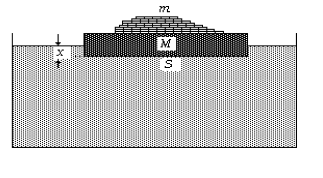

I'm confused about the following kind of situation. Consider a block of density ##\rho_b##, mass ##M_b## and section ##S_b## that floats on a liquid of density ##\rho_l##, in a tank of section ##\mathcal{S}##. On the block there are some objects (all equal), of density ##\rho_o## and mass ##m_0##.
Diagram of a rectangular block labeled M floating in a liquid tank, with a stack of identical objects labeled m on top, and depth marker x at the liquid surface beside the block.
Now consider two cases
1. The objects are removed from the block
2. The objects are thrown in the liquid
What does happen to the system?

Initially the block is immerged for an height ##h_1## such that $$(h_1 S_b) \rho_l= M_b + \sum m_{o}$$
When objects are removed the height of the immerged part is ##h_2## such that
$$(h_2 S_b)\rho_l= M_b$$
From here I can calculate the variation of immerged volume $$\Delta V= S_b (h_1-h_2)$$
My main question is: who does move? The liquid, the block, or both?
As far as I understood **only the liquid moves** going down, of an height ##h^*## given by
$$\Delta V=(h_1-h_2) S_b= \mathcal{h^*} \mathcal{S}$$
But I'm not convinced because maybe also the block moves, precisely it may go up. In the solution I proposed the block does not move at all, it's the liquid that moves below it. Is that correct?
Case 2
After the height ##h^*## calculated in case 1, the fluid goes up of an height ##\bar{h}## because the objects are (at least partially) immerged in the fluid.
$$ \sum m_o =\rho_l \bar{h} \mathcal{S}$$
Summing up the total change i height of the fluid should be $$\Delta h= h^*- \bar{h}$$
As said above all of this assumes that only the fluid moves, while the block does not. So my question is: is that assumption correct? (And, possibly, why?)

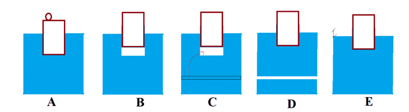

So actually both the block and the fluid do move.. Since my aim is to find the variation of fluid level I tried to interpret the phenomenon of case 1 as described by my answer in the question, now that I know that the block moves too. I made a drawing, maybe a little strange, I would like to ask you if that would be correct (as far as the exercise is concerned)
Five-panel sequence labelled A to E of a rectangular block in a blue liquid tank, with a small circle on top in A, the block rising in B, a blank gap and a slice below it in C and D, and the block and liquid shifted down in E.
I marked the steps with letters
  • ##A##: block and objects on liquid
  • ##B## : object is removed. Here i foucused only on the motion of block. The block moved up of a certain height, leaving a blank space below it (again, of course that is not true, is just to understand the exercise). The height the block moved is such that the blank volume is the one called ##\Delta V## in my question.
  • ##C## : Here I imagined that I can replace ##\Delta V## with a "slice" of fluid from below (in this way I can relate ##\Delta V## to the level of the liquid in the tank of section ##\mathcal{S}##)
  • ##D## : ##\Delta V## is replaced so now there is another blank volume, equal to ##\Delta V##, below
  • ##E##: I imagined to move everything, as a rigid body, down, to fill the new blank volume
Total result: the height of the block and the level of the fluid changed both.
As said above this is just an attempt to justify practically my answer, after having learned that the block moves. Would you be so kind as to suggest me if this is the solution I proposed is correct even if the block moves?

Yes, that reasoning all looks correct.
