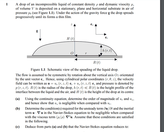

Hi sorry about the way I've posted I'm new to this site. Anyway basically I've been set this question which should be attached to this post, I have attempted to do this question but I'm having trouble in forming an equation in the first place. I'm unsure where to start, I understand I need to use the equations mentioned I'm just stuck on how to form them. Any help will be very much appreciated.

For now, what is the equation of continuity for an incompressible fluid in axisymmetric flow, expressed in cylindrical coordinates? Please write the equation down.

I think it's this differential equation equation: δρ/δr+1/r(δ/δr(rρvr)+1/r(δ/δθ(ρvθ)+δ/δz(ρvz).

I don't see an equal sign,, so this is not an equation. Also, if the fluid is incompressible, what can you say about ##\rho##? Also, if the system is axisymmetric, what can you say about the derivative with respect to z? Also, please read the PF tutorial on LaTex, and then use LaTex to write your equations and expressions.

Oh my bad this is the equation I believe: \frac{\partial\rho}{\partial t}+\frac{1}{r}(\frac{\partial}{\partial r}(r\rho v_r))+\frac{1}{r}(\frac{\partial}{\partial \theta}(\rho v_\theta))+\frac{\partial}{\partial z}(\rho v_z)=0 . For an incompressible fluid the density is constant and that the divergence of u is 0. For the derivative with respect to z, I'm not sure I think it equals 0? I thought that the derivative with respect to theta equals 0 since its a axisymmetric flow?

Sorry, I meant the derivative with respect to theta. Now, please write out the equation again for the case of constant density and zero derivative with respect to theta. And, again, please use LaTex.
Oh ok, I assume it's a steady flow therefore the first term goes to 0. I think this is the equation: $$\frac{1}{r}(\frac{\partial}{\partial r}(r\rho v_r))+\frac{\partial}{\partial z}(\rho v_z)=0 $$

Excellent. But the density is constant, so it factors out. Please rewrite the equation without the density in there.

That's not how to do it, and isn't even correct. Here's what I'd like you to do. Start by making the following substitutions into the differential equation:
$$r=\bar{r}R(t)$$
$$z=\bar{z}H(t)$$
$$v_r=\bar{v_r}v_{r0}$$
$$v_z=\bar{v_z}v_{z0}$$
where the overbear parameters are dimensionless radius, dimensionless z coordinate, dimensionless radial velocity, and dimensionless axial velocity, and ##v_{r0}## and ##v_{z0}## are characteristic velocities in the radial- and axial directions, respectively. What do you get when you make these substitutions?

Ok I did the substitution and I got this:
$$\frac{1}{\bar{r}R(t)}(\frac{\partial}{\partial r}(\bar{r}R(t)\bar{v_r}v_{r0}))+\frac{\partial}{\partial z}(\bar{v_z}v_{z0})=0$$
I am I right in thinking the $$\bar{r}R(t)$$ term cancels out with the other term? And also I wasn't sure if you could substitute in for z since its part of a partial differential?

I've decided it would have been better to normalize the spatial coordinates in terms of the maximum radius and maximum height at time zero. Thus, with this change, we would have:
$$r=\bar{r}R(0)$$
$$z=\bar{z}H(0)$$
And the continuity equation would become:
$$\frac{1}{\bar{r}R^2(0)}(\frac{\partial}{\partial \bar{r}}(\bar{r}R(0)\bar{v_r}v_{r0}))+\frac{1}{H(0)}\frac{\partial}{\partial \bar{z}}(\bar{v_z}v_{z0})=0$$Since the characteristic velocities and dimensions are taken as constants, they can be factored out of the derivatives, to yield:$$\frac{v_{r0}}{R(0)}\frac{1}{\bar{r}}\frac{\partial}{\partial \bar{r}}(\bar{r}\bar{v_r})+\frac{v_{z0}}{H(0)}\frac{\partial}{\partial \bar{z}}(\bar{v_z}
)=0$$or, equivalently,
$$\frac{1}{\bar{r}}\frac{\partial}{\partial \bar{r}}(\bar{r}\bar{v_r})+\left[\frac{v_{z0}R_(0)}{v_{r0}H(0)}\right]\frac{\partial}{\partial \bar{z}}(\bar{v_z}
)=0$$
OK so far?

So far, we have specified the characteristic lengths in the radial and thickness directions, but we haven't said anything about the characteristic velocities. We can now deal with that by, with no loss of generality, setting the dimensionless group in brackets in the final equation of post #16 equal to unity: $$\frac{v_{z0}R_(0)}{v_{r0}H(0)}=1\tag{1}$$such that our dimensionless continuity equation now becomes simply:
$$\frac{1}{\bar{r}}\frac{\partial}{\partial \bar{r}}(\bar{r}\bar{v_r})+\frac{\partial}{\partial \bar{z}}(\bar{v_z}
)=0\tag{2}$$If you use Eqn. 1 to express the characteristic velocity in the thickness direction ##v_{z0}## in terms of the other characteristic parameters for the system, what do you get? What does this tell you about the magnitude of the characteristic velocity in the thickness direction in comparison with the magnitude of the characteristic velocity in the radial direction? (This provides the answer to part (a) of your problem)

Ok I think I understand it now, I rearranged to get this:
$$v_{z0}=\frac{H(0)}{R(0)}v_{r0}, v_{r0}=\frac{R(0)}{H(0)}v_{z0}$$
And since H(0)<<R(0), it means that the magnitude of the vz component is negligible compared with the vr term.

Correct. Ready to tackle part (b) using analogously methodology?
Yes I think so, I have made an attempt on part b using a similar method we just used by using dimensionless variables into the Navier Stokes equation:
$$ \rho(\frac{\partial u}{\partial t} + u \cdot \nabla u)= \rho g- \nabla p+ \mu \nabla^2u$$
$$\hat{u}= \frac{u}{U}, \hat{x}=\frac{x}{L}, \hat{t}= \frac{t}{T}, \hat{p}= \frac{pL}{\mu U}$$
Rearranging and substituting them back into the Navier Stokes equation and knowing the Reynolds number, Froude number and frequency parameter:
$$F_r=\frac{U}{\sqrt{gL}}, \beta=\frac{L^2}{vT}, Re=\frac{UL}{v}, v=viscosity$$
The equation reduces to:
$$\beta \frac{\partial \hat{u}}{\partial \hat{t}}+Re\hat{u} \cdot \hat{\nabla} \hat{u}= -\hat{\nabla}\hat{p}+\hat{\nabla^2}\hat{u}+\frac{Re}{F_r^2}\frac{\hat{g}}{g}$$
Where ##\frac{\hat{g}}{g}## is a unit vector expressing the direction of the body force.
In order for the left hand side to be negligible Re<<1 and ##\beta<<1##, then by reverting back to dimensional variables we find:
$$-\nabla p+\mu \nabla^2u +\rho g=0$$
I think I've done this in the correct way, let me know what you think.

I think you did it correctly. I would have done it a little differently (by working with the equations in component form), but you definitely have the right approach.
