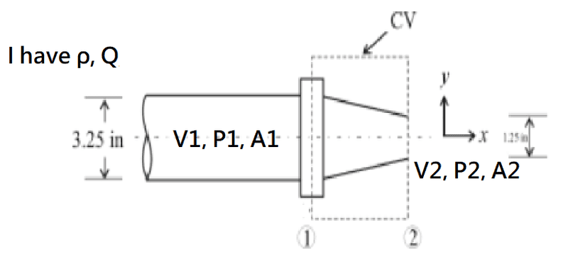

Water flows steadily through a 3.25-in-diameter pipe and discharges through a 1.25-in-diameter nozzle to atmospheric pressure. The flow rate is 24.5 gpm. Calculate the minimum static pressure required in the pipe to produce this flow rate. Evaluate the axial force of the nozzle assembly on the pipe flange.
ρQ*V1+P1*A1 = ρQ*V2+P2*A2
Let me start off by saying that I have found (or is given) all of these: ρ, Q, V1, V2, P1, P2, A1, A2 (V being the velocity here). So no problem with Bernoulli or the Continuity equation calculations.
I am just struggling with drawing the FBD in order to evaluate the axial force, Fx
I know we need to write an x-momentum equation to the control volume: ρQ*V1+P1*A1 = ρQ*V2+P2*A2
But I don't know which side the Fx should be added on in the above equation. It says "axial force of the nozzle assembly on the pipe flange", so if I had to guess, Fx would point towards the left. But the bigger problem here is that I'm not even sure whether the terms I have on the LHS (and RHS) causes a force that acts to the left or right of the control volume.

When you say the force the nozzle exerts on the fluid, is that at point 1 or point 2? The question says the axial force of the nozzle assembly on the pipe flange, isn't the pipe flange that rectangular piece between the pipe and the nozzle? I guess I'm just not understanding the whole picture of the forces involved. Would really appreciate a diagram.

I know P2=0. When you say P1 acts on the left side of the CV, that could be one of two possibilities below and I really don't know which.

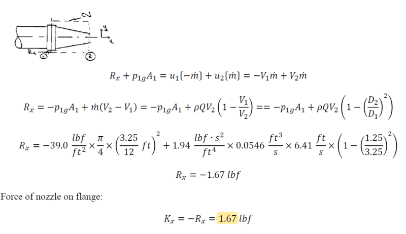

I know that you guys are trying to help users derive the answer without telling them, but the issue here is I already have the answer and the equation from the manual. But I just cannot for the life of me understand what the hell it's drawing. This isn't for a homework I need to hand in or anything, I'm just reading through the book's examples. Please just explain to me how the forces are acting on the CV with arrows.

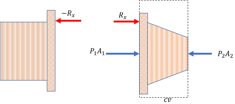

My understanding is they are freeing the control volume from the pipe, replacing the effect of the pipe with an external force on the control volume ##R_x##. They are asking for the newtons 3rd law compliment of that force ##-R_x## which is the force the nozzle (the control volume) applies to the pipe.

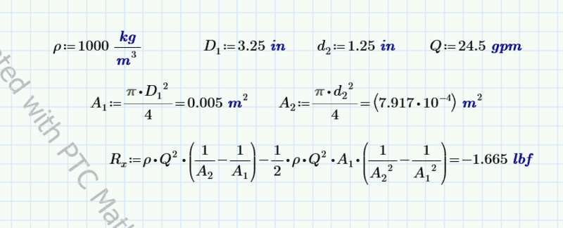

OK so... since ρQ*V1+P1*A1 turns out to be greater than ρQ*V2 (P2=0), the force acting on the CV (or nozzle) by the pipe must be to the left (negative X direction).
And therefore the force on the pipe by the nozzle is to the right (positive X direction)?

The pressures are absolute in the diagram. They are asking for the force the nozzle applies to the pipe, which is ##-R_x##
Sum of the forces = rate of momentum exiting control volume - rate of momentum entering control volume.

Except Rx turns out to be negative and -Rx turns out to be positive right?
How do you represent the terms ρQ*V1 and ρQ*V2 in the FBD?
That’s what your solution says. It seems wrong to me, I’ll check it if I get a chance later.
They are usually presented in a separate diagram, called a “momentum diagram”

Yeah, ##R_x## comes out negative.
