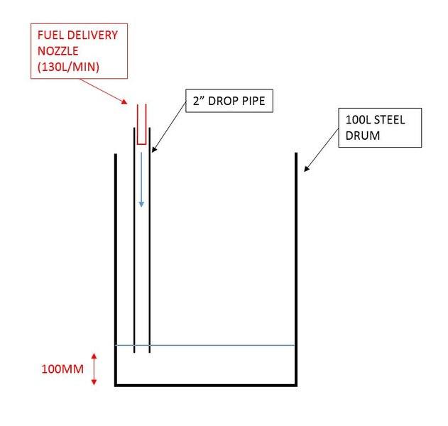

Hi everyone,
I have a real life fluids problem I am trying to solve theoretically.
During a commissioning exercise we needed to discharge fuel into a 100L steel drum to test flow rates for a new re-fuelling skid. To minimise turbulent flow and static build up a drop pipe was used for the hose nozzle to discharge into.
The drop pipe was made from 2" pipe and suspended approx 100mm from the bottom of the drum. During the commissioning exercise, fuel was discharged into the drum via the drop pipe at a rate of 130L/min. However once the level of fluid reached the bottom of the drop pipe, the 2" pipe could not handle the flow delivery and the flow path reversed back up the drop pipe and cut out the delivery nozzle.
We have solved the issue by fabricating a new drop pipe from 3" pipe which allows the fuel to be delivered to the drum safely with no backflow concerns.
I'm hoping someone can explain this issue theoretically with a fluid diagram / Bernoulli equation etc?
See attached a diagram to better explain the scenario.
Thanks for your help. Any questions let me know

Did you keep the same volumetric flow rate (130L/min) after you switched to the 3'' pipe? If yes then I think I have a qualitative explanation of what happened.
The atmospheric pressure plus the pressure from the weight of the fluid in the drum overcomes the pressure of the fluid in the delivery pipe. Thats why you had back flow.
When you switched to 3'' pipe while keeping the same volumetric flow rate, the velocity of the fluid in the pipe became smaller (because the vol. flow rate equals ##Sv## where S the cross area of the pipe and v the velocity of the fluid, so if ##S## becomes larger, ##v## has to become smaller in order to keep ##Sv## constant), and by Bernoulli's principle smaller velocity means bigger pressure. So the bigger pressure inside the 3'' pipe (relative to the pressure of the 2'' pipe) made it possible to successfully fill the drum.

Thanks Delta. Yes it was the same flow rate.
Your explanation makes some sense. Could you attempt to put numbers to the Bernoulli equation?
It was actually 1" pipe we originally used (not 2" as explained incorrectly before)
well the velocity of the fluid in the 3'' pipe was nine times smaller than the velocity of the fluid in the 1'' pipe.
Bernulli's equation ##\frac 1 2 \rho v_{1''}^2+p_{1''}=\frac 1 2 \rho v_{3''}^2 +p_{3''}## and replacing ##v_1=9v_3## we ll get after some algebra that ##p_{3''}=p_{1''}+40\rho v_{3''}^2##
If I calculated correctly ##v_{3''}=0.475m/s## based on the flow rate and the pipe diameter (is it 3 inches diameter or 3/4 inches?) . Need to know the density of the fluid to find how much was the increase in pressure due to the lower velocity inside the 3''pipe.

I agree with this explanation, but I would like to put some numbers on it. What is the length of the drop pipe, and/or the depth of the liquid in the tank when the tank is considered full? Also, what is the diameter of the nozzle?

Hi Chestermiller,
Some of the numbers i gave earlier were wrong. The drum is actually 200L and measures approx 880mm high.
The drop pipe was constructed from a 3"x1" reducer welded to a length of 1" pipe. The drop pipe was inserted into the drum opening so that the bottom of the pipe rests approx 100mm above the bottom of the drum. The reducer sits above the level of the drum and allows the nozzle to be inserted. Nozzle diameter is 38mm (approx 35mm internal dia).

What’s the approximate viscosity of the fuel?
At 25degC kinematic viscosity of JET A1 is approx 1.5 mm^(2)/s and density of approx 800kg/m^3
A couple of other questions:
Do you know whether the drop pipe is running full during the situation in which the lower exit is not submerged? Or is there a continuous path for air from the top to the bottom?
The reducer: Is that a converging section (like a funnel) that makes direct contact and is sealed to the top of the drop tube?

The reducer is a standard ASME pipe fitting that was welded to the 1" pipe. It allowed us to insert the nozzle into the drop pipe.
Regarding the path of air its too hard to say. I would assume at 130L/min the 1" pipe would have been close to full of liquid if not completely full
I'm going to do some "walk-through" calculations to try to get a handle on what is happening. These first calculations will focus on the case of the 1" drop pipe, where the fluid level has not risen enough to block the outlet. I'm going to assume that the pipe is running full. I want to look at the pressure variations in the pipe, and to see how the hydrostatic component compares with the viscous frictional drag component. For a fluid flow of 130 lpm, the average downward flow velocity is $$V=\frac{130000}{60\left(\frac{\pi (2.54)^2}{4}\right)}=428\ cm/s=4.28\ mps$$ The fluid density is 800 kg/m^3, so the mass flow rate is:
$$\dot{m}=\frac{130(0.8)}{60}=1.73\ kg/s$$The fluid viscosity is 0.0012 Pa.s, so the Reynolds number is:
$$Re=\frac{4\dot{m}}{\pi D \mu}=\frac{4(1.73)}{\pi(0.0254)(0.0012)}=72400$$
This makes the flow turbulent. From the Blasius equation for the fanning friction factor, we have:
$$f=\frac{0.079}{(Re)^0.25}=0.00482$$
Based on this, the viscous shear stress on the wall is: $$\tau=\frac{1}{2}\rho V^2f=(0.5)(800)(4.28)^2(0.00482)=35.2 Pa$$
The frictional pressure drop contribution in the tube would be $$\Delta P=4\frac{L}{D}\tau=4\frac{0.88}{0.0254}35.3=4892 Pa$$
The hydrostatic pressure contribution would be $$\Delta P=\rho g L = (800)(9.8)(0.88)=6899 Pa$$
Since, for the open tube, the exit pressure is 0 Pa gauge, the pressure at the top of the drop tube would be predicted from these calculations to be 4892 - 6899 = -2007 Pa = -0.3 psi. So, if the tube were running full, the pressure at the entrance to the drop tube would be a slight vacuum. This is because the weight of the fluid would be more than the ability of the viscous frictional force at the wall to support that weight. It isn't clear what is happening in the region approaching the drop tube from above that would cause this small pressure deficit. To be sure though, the frictional drag in the 1" tube at least comes somewhat close to offsetting the weight of the fluid. This would not be the case in the 3" drop pipe, where the hydrostatic contribution would not change, but the frictional component would be much smaller. This would allow the fluid to flow downward much more freely.
The effect of blockage at the bottom of the drop tube on the pressure distribution and downward flow would not be immediately obvious. It would seem that, for the 1" pipe, it could flip the situation so that the hydrostatic component is no longer sufficient to overcome the frictional drag plus the exit pressure resistance. To quantify the exit pressure resistance, it probably would help to carry out a computational fluid dynamics calculation. But I think it would be very unlikely that the resistance at the exit of the pipe would be enough to overcome the hydrostatic contribution in the 3" pipe (where frictional drag is not really playing much of a role).
Hmm. Something odd here. Your flow rate is about 2 l/s. That doesn't seem unreasonable for water under 3 feet of head to fall into existing pool of liquid. I'm wondering if it is an 'entraining' effect. When the bottom of the pipe is open, the air column in the pipe is at atmospheric pressure. As the opening closes, the falling liquid carries air underneath, dropping the pressure in the drop pipe, and causing the nozzle shut down. (Do they respond to a drop in back pressure as well as a rise?)
This could be tested by putting a hole, say 1/4" in the side of the top of the drop pipe.
The other possibility is some sort of hydraulic jump effect. On contact with the lip of the down pipe, flow abruptly slows, backing up the pipe. Increase in pressure trips the nozzle.
* Test: Attempt it again, but after it shuts off the first time, squeeze the nozzle slowly to establish a flow. I've had some cars do this -- you had to accelerate the fill rate slowly.
* Test: Cut the bottom of the drop pipe at a 45 degree angle. This means the transition from an air exit to a liquid exit is slowed down.
* How much time between the end of the drop pipe being immersed, and the fluid backing up and shutting off the nozzle. How does this compare to the time to fill a 1" pipe at 130 l/m?
* What happens if only the bottom 6 inches of the drop pipe are replaced with larger pipe? Or the bottom 18 inches?
* what is the result if you perforate the drop pipe, putting a line of 1/4" holes along it's length.
