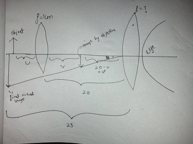

In a compound microscope, the magnified virtual image is formed at a distance of 25 cm from the eye-piece. The focal length of its objective lens is 1 cm. If the magnification is 100 and the tube length of the microscope is 20 cm, then the focal length of the eye-piece lens (in cm) is __________.
None
##\frac{1}{v}−\frac{1}{u}=\frac{1}{f}##
For objective lens of focal length 1 cm
##\frac{1}{v}+\frac{1}{u}=1##
##\frac{1}{v}=\frac{u−1}{u}##
##v=\frac{u}{u−1}##
Distance from eyepiece = 20-v=u'
u′=##\frac{19u−20}{u-1}##
Magnification=(Angle subtended at eye by final image)/ (Angle subtended at eye without compound microscope when object is kept at 25 cm from eye)
Angle subtended at eye by final image= (size of final image)/25cm
=Angle subtended by the image of the objective lens=(size of image by objective lens)/(20−v)
Angle subtended at eye without compound microscope when object is kept at 25cm from eye= (size of object)/(25)
We know that
=(size of image by objective lens)/(Size of object)=##\frac{v}{u}##
=##\frac{1}{u-1}##
So accordingly magnification
=((size of image by objective lens) (25))/((20-v)(size of object))
We know that 20-v=##\frac{19u-20}{u-1}##
[LaTeX typo fixed by a Mentor at OP request]
So solving this we get u as 81/76
20-v=u'=19/5
So substituting this to lens formula for the eyepiece we get
##\frac{-1}{25}+\frac{5}{19}=\frac{1}{f}##
So f I get as 4.48 cm....
However the answer is 6.25, I don't know where I'm going wrong please help. Please refer to my solution and point out where I went wrong if possible
Your work looks correct to me. I did notice a typographical error where you wrote
tellmesomething said:
We know that 20-v=##\frac{19-u}{u-1}##
In the first line you should have 20 - v = ##\frac{19u-20}{u-1}##, as you had obtained near the beginning of your calculations.
Nevertheless, I agree with u = 81/76. I get the same final answer of 4.48 cm for the eyepiece focal length.

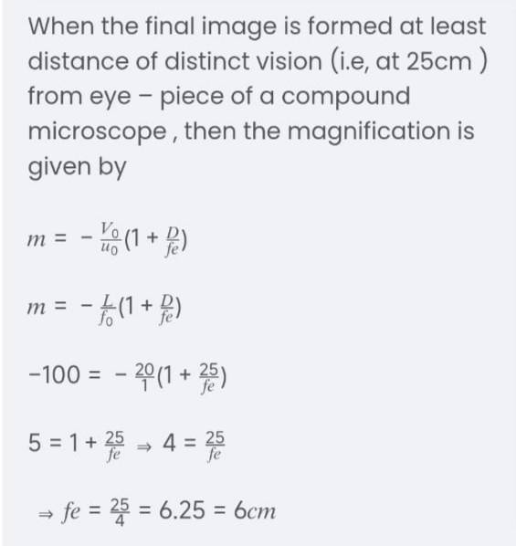

This is a question from a competitive exam and the answer they released was 6.25, the supporting solution was this
So im unsure what different thing they did, till the first formula it makes sense, but then they equated vo/uo to L/fo
(O is for objective lens, e is for eyepiece)

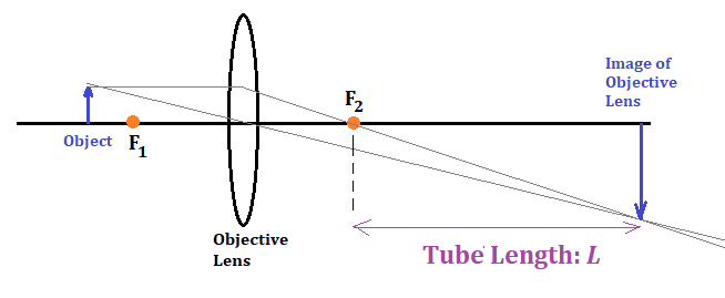

We interpreted the "tube length" as the distance between the two lenses. But I did some searching. I found that there are different definitions of tube length. The tube length is sometimes defined as follows:
F1 and F2 are the focal points of the objective lens. The tube length is the distance between ##F_2## and the image of the objective lens. This length is sometimes called the "optical tube length". For example, see figure 3 here. Also, I found this definition in my old copy of Optics by Hecht and Zajac (1st edition).
I guess this definition is for convenience. You can show that with this definition the overall magnification of the microscope takes the simple form used in their solution: ##M = -\dfrac {L}{f_o} \cdot (1+\dfrac D {f_e})##.
Anyway, your analysis is correct for your interpretation of tube length.

The formula ##M = -\dfrac {L}{f_o} \cdot (1+\dfrac D {f_e})## is "exact" if ##L## is defined as in post #4. (Here's another example using that definition). In this case, ##f_e = 6.25## cm is the accurate answer for the problem stated in the OP.
If ##L## is defined as the lens-to-lens distance, the accurate answer for ##f_e## is 4.48 cm. @tellmesomething got this result by working things out from scratch! 👍👍👍
