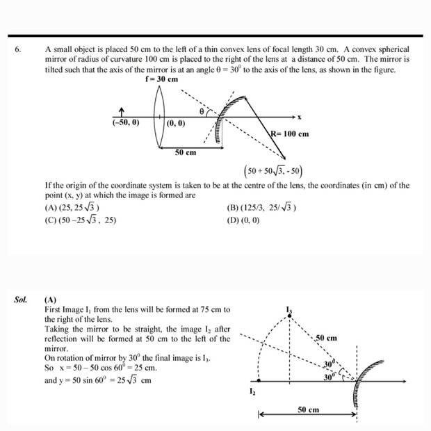

Find the position of final image
Lens formula: $$\frac{1}{v}-\frac{1}{u}=\frac{1}{f}$$
Mirror Formula: $$\frac{1}{v}+\frac{1}{u}=\frac{1}{f}$$
Mirror Magnification = ##\frac{-v}{u}##
Lens Magnification =##\frac{v}{u}##
I think the given solution is wrong.
The lens forms image at ##(+75,0)## which is ##25 cm## from pole of the convex mirror which acts as virtual object for mirror.
It is true that the reflected ray is rotated by ##2\theta## as in case of plane mirror. Rotation of Spherical Mirrors
But that doesn't necessarily mean that the image is rotated by ##2\theta##

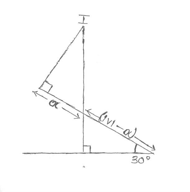

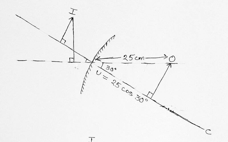

Since the mirror is tilted the principal axis is tilted. It is a spherical mirror so the point object should be treated as the tip of an extended object and the height and position of head of extended object should give coordinates of point image.
According to this diagram:
$$\frac{1}{v}+\frac{1}{u}=\frac{1}{f}\implies \frac{1}{v}+\frac{2}{25\sqrt{3}}=\frac{1}{50}$$
Therefore $$v=\frac{50\sqrt{3}}{\sqrt{3}-4}$$ ## \text{ v is along tilted axis and measured from pole of mirror}##
Then from the formula of magnification:
$$\frac{I}{25/2}=\frac{-v}{25\sqrt{3}/2}\implies I=\frac{50}{4-\sqrt{3}}$$
Solving this triangle,
$$(|v|-I\tan 30)×\cos 30=50-x$$
$$y=\frac{I}{\cos 30}+(|v|-I\tan 30)×\sin 30$$
$$x=\frac{50(3-\sqrt{3}}{4-\sqrt{3}}\text{ ; } y=\frac{50\sqrt{3}}{4-\sqrt{3}}$$
These equations give the x and y coordinates of the image.
The answer does not match. There is yet another mistake in the solution, I think. I believe that this image is not the final image. The final image is formed after refraction of this image by lens.
So am I horribly misunderstanding the question? Am I terribly mistaken or is the solution wrong this time??
How to solve it correctly?

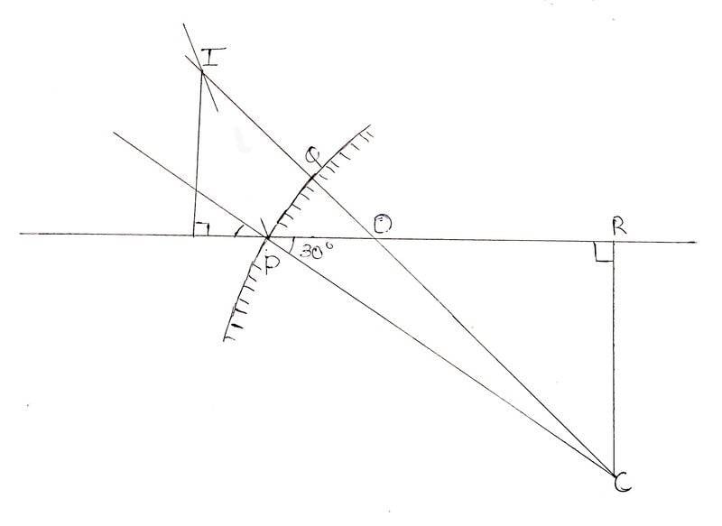

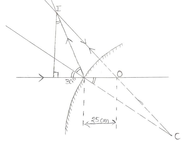

After reading that article I came up with these diagrams:
For small aperture, tangents approach the arcs
Therefore:
I haven't solved these triangles but I think the results will be similar from the looks of it. Please help solving this
Does the answer match my solution or the official one?
I don’t understand your first diagram in post #8.
Where is the image from the lens? Where does the ray reaching I from the line CO come from?
O is the image from the lens (virtual object for mirror)
I is the image of O
Since C is center of curvature, ray of light along CO is case of normal incidence and retraces its path after reflection.
I is the image of O
Ok, that works. I was confused because I expected to see two points (or a line segment) representing the image from the lens. The point you found only shows where the image ends up for that part of the object which lies on the axis of the lens.

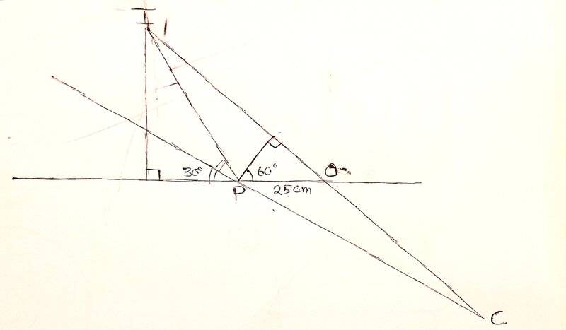

The only problem I have with your solution in post #8 is spherical aberration. Usually, one only considers rays close to the axis. Your two rays are a wide angle apart.
As the picture here shows…
https://en.wikipedia.org/wiki/Spherical_aberration
the sharpest image lies on the line through the object and the centre of curvature. That implies the right combination of rays to consider is your IOC ray and another nearby, not the one along the axis of the lens.
Update:
Doh! That is the answer. The final image is the same as if the object were at O and the sphere were mirrored on the inside. So treat the mirror axis as COI and apply the standard formula. Do not use the ray along the lens axis.
The only problem is : I can't seem to find the angle between IOC and x-axis(lens axis). So I can't find object distance. I think it's approximately ##30°##
Call the point where the mirror intersects the lens' axis P.
You know OP, CP and angle CPO. That is enough to find all sides and angles of triangle OPC.
