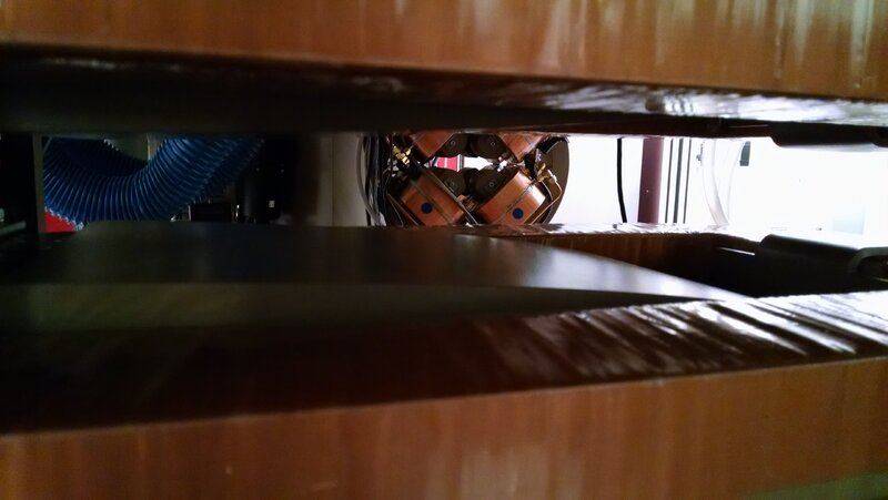

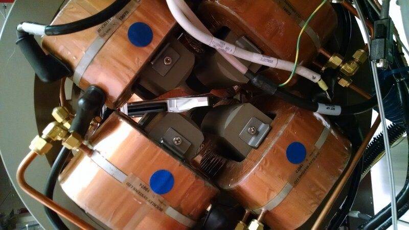

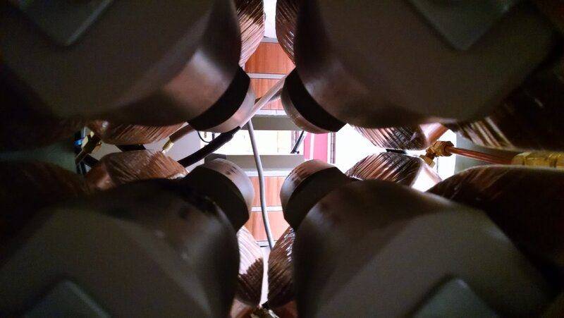

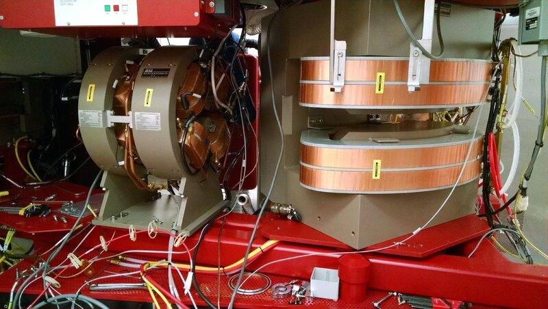

Some reference pictures of small industrial ion accelerator Quadrupole magnets with the vacuum chamber beam-guide removed. It's easier to see the scale and physical properties with something smaller than the LHC.
IMG_20160418_105841772.jpgIMG_20160418_110136807.jpgIMG_20160418_105816780.jpgIMG_20160418_105755249.jpg
