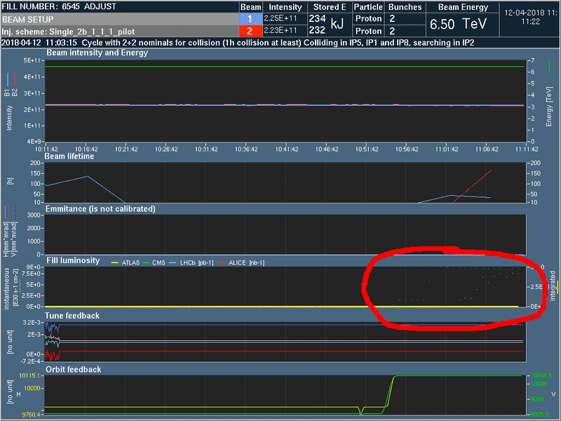

We've had three fills with 600b. There needs to be another using 96b trains.
The timetable for the week is filled in (see below). A lot of the commissioning steps have been completed already, but there are still a few more to be done in the next couple of weeks. It's going to be solid physics from Friday afternoon and over the weekend. Optimistically, if a step in https://lpc.web.cern.ch/RampupPolicies.htm takes 4 or 5 shifts (20 hours stable beams in 3 fills), the 1200b step could start on Sunday morning. Compare this with the schedule for the year, which says 1200b on 11th May.

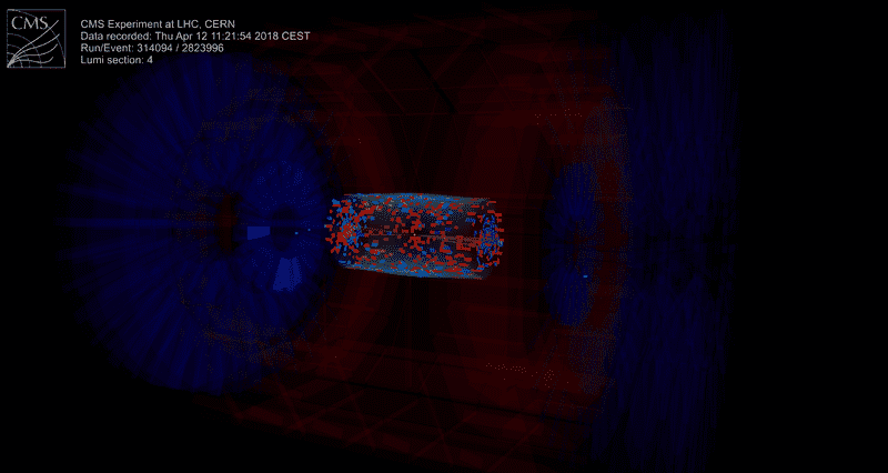

dukwon said:
I can’t possibly believe that they can actually image the proton bunches! Is that what we’re seeing in the lower of the two pics or it is something else?IH
  • #41
The lower image is an computer animation highlighting some detector components that saw some collision product flying through them. Other detector components are darker/more transparent. In addition some reconstructed particle tracks are marked with orange lines.
Here is a similar one, but zoomed in. I think the cones mark regions with a very high density of tracks ("jets").

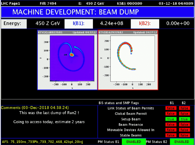

Ion run is over. LS2 started about 2 hours ago.

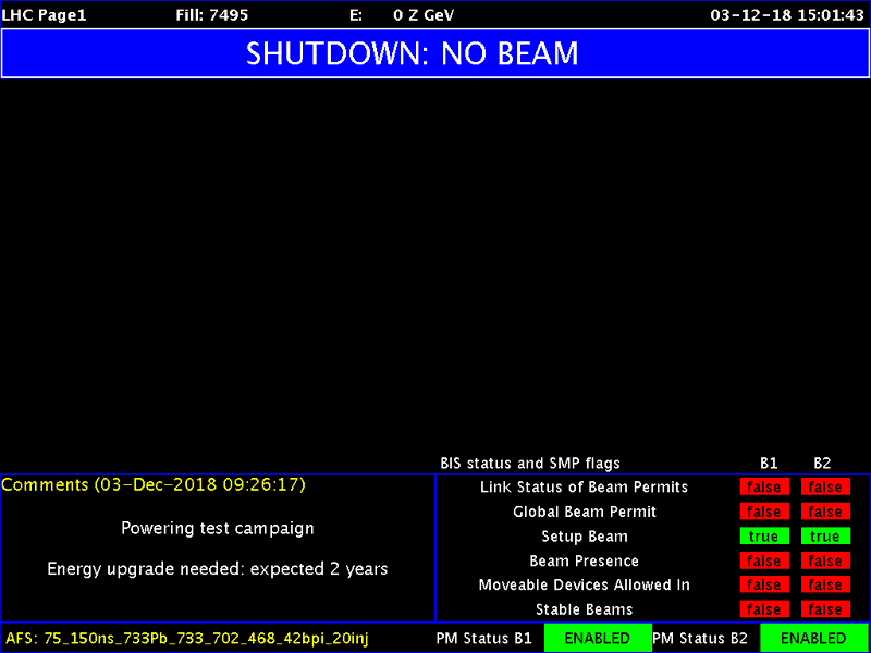

This is the LHC Status Page 1 this morning- There is some humor in the comments.
