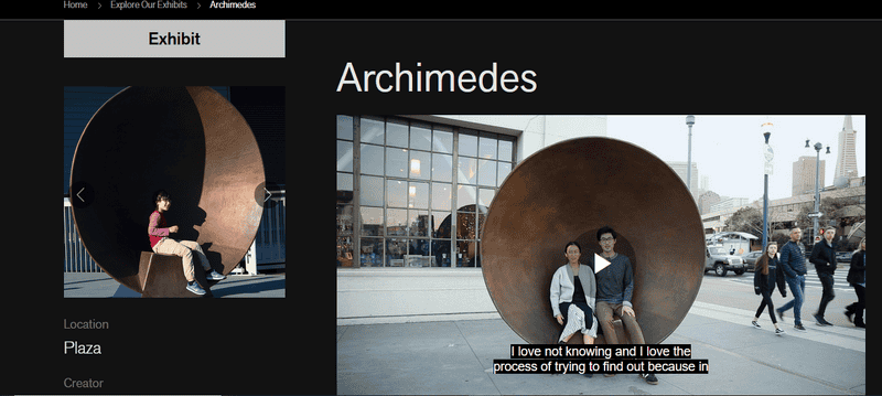

gensahilsingh said:
parabolic reflectors,
If you have a science museum near you like the San Francisco Bay Area Exploratorium, you can experience a focused long-range sound exhibit like this one:
https://www.exploratorium.edu/exhibits/archimedes
