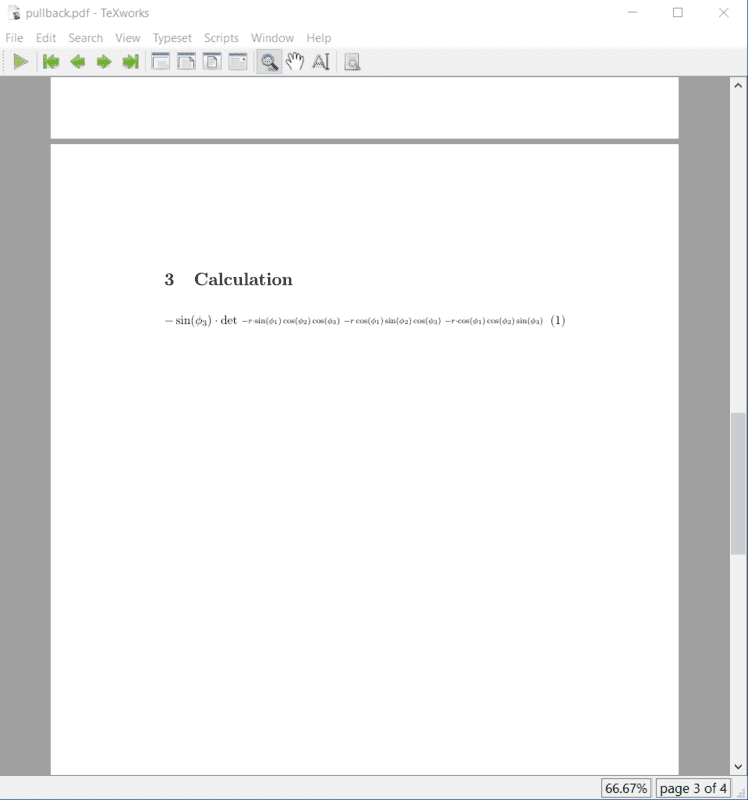

Suppose I were doing an informal presentation on differential forms. I am strapped on presentation time, and need to pass out a long calculation. Can I use LaTeX to type it out, or is it more advisable to do it by hand, scan it, print copies, and distribute them to the class?
Is it possible to typehttps://drive.google.com/open?id=186OoXjmVjb3nhXjSBKEAq2u_6MF-UXlm into LaTeX, or should I just print out the thing as it is? If the former, I do not know how I would go about it; the matrices seem much too wide for me to fit onto a letter-size page. For the record, the typeset pdf looks something like:
And that's just the first term of the first determinant expansion.
Also, this does not relate to my topic at all, but I'm using LaTeX for the first time, and now I am wondering what I was thinking when I chose to use Microsoft Word to type out all my lab reports and the like during my academic career. It seems faster and easier to type out equations than if I am using the office application. It also just looks much cleaner and nicer than my Word-processed reports. Now I feel a bit foolish and regretful.

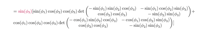

Now I am worried that people will not have the sanity to check the work at the bottom of https://drive.google.com/open?id=1PUufFSfCdoDw42GeFIO2pUtAGNLvWUDk.
I should definitely do something for the terms I simplified using the identity ##(\sin^2 + \cos^2)(x)=1##, and I feel like I should color-code some of these terms, or something.

Don't know if my comments post was deleted, or that I simply messed up and didn't post. Your specimen sure looks different from the last time I saw it.
I had:
  • kudos for the ##\TeX##ing ! Was it indeed a few hours, or much more ?
  • pity you don't post the ##\LaTeX## source, this makes referring to a specific place difficult for us. But I understand it if you worry about copying.
  • loose the brackets: ##\ \cos\phi_1 \ ## instead of ##\ \cos(\phi_1) \ ## is easier on the eyes
  • align, manually or with \begin {align*} etc. e.g. for this make the big ( line up vertically.
  • another way to align is with \phantom{...} . The ... is typeset (for h and v spacing) but not rendered.
  • adjust sizes. The [ ] above should be bigger than the big (. Use \left [... \right ] or do it manually with \big \ Big \bbig \Bbig etc.

I wanted to fix it some more, then kept on re-uploading my edited versions. I apologize for inconveniencing you and inadvertently wiping your comments. Uploading or sending work, realizing I could have done something better, and then re-sending multiple revisions is a bad habit of mine that I really should have quit by the end of my academic career.
I'd say so. At most, this particular document took six hours, including the time I needed to learn some of the formatting I did not learn on here while typing out posts.

Duly noted. Thanks for the tips.
Okay, through heavy revision, I think I have a https://drive.google.com/drive/folders/1V8a0NFuTeh3PMXOckBPAOqbMas69q8MY?usp=sharing of the calculation.
Additionally, I have made notes in the TeX document asking for help on how to do so and so.
