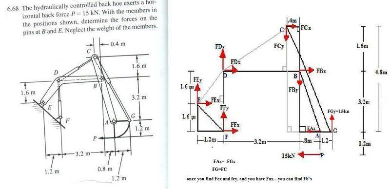

Im having problems figuring out this Statics question
I feel like I can solve it, But it has been bugging me for weeks
Here it is. and Here is a quick FBD and notes I posted from others
Would Anyone let me know If the FBD is correct?
Im not asking for the answer. I honestly just want to learn the correct process to accomplish this question. THX
Nobody?
First start with body CBA and take it from there. This problem is simply laborious nothing else.
OK
So I don't start with the Reactions at E and F?
Having a hard time Isolating for EX
Nevermind. Figured it out. I over engineered the first part. It was quite simple
