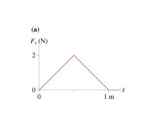

The figure below shows the force exerted on a particle that moves along the x-axis. Draw a graph of the particle's potential energy as a function of position from x=0 to x=1.1 . Let U be zero at x=0.
F=-dU/dx
I decided to divide the force graph into three separate graphs:
From x=0 to x=.5: F(x)= 4x
From x=.5 to x=1: F(x)= -4x + 4
From x=1 to x=1.1: F(x)= 0
I then integrated each equation, and multiplied them by -1, getting U(x)= -2x^2, U(x)= 2x^2 - 2 and U(x)= 0, respectively.
When I try to graph these equations, only the first one and the last one, U(x)= -2x^2 - 2 and U(x)= 0, seem to give me the correct answer. Can someone help me figure out where I went wrong?

Your U(x) should be continuous. If you define U(0) to be 0 then U(1) isn't 0. Adjust your constants.

In each integral, you get an unknown constant. To figure out what the constant is for that integral, you have to plug in known values for U and x at the start of that range.
I don't see how you got 2-2x2 by integrating -4x+4.

It should read 2x^2 - 4x. My mistake.
And I forgot all about solving for the constant first...whoops! I figured it out, though. Thanks! ^.^
