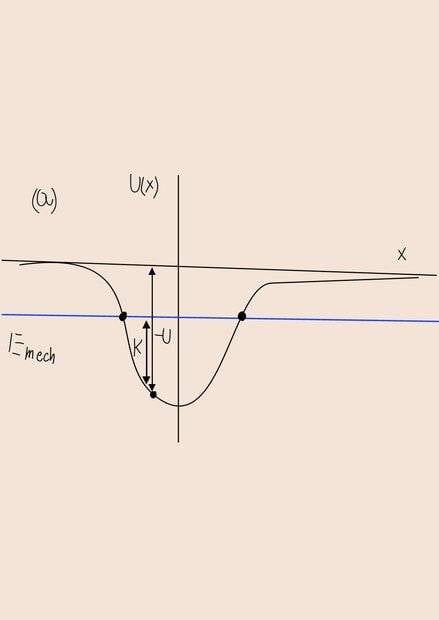

A particle of mass ##m## moves in one dimension. Its potential energy is given by $$U(x) = −U_0e^{-x^2/a^2}$$ where ##U_0## and ##a## are constants.
(a) Draw an energy diagram showing the potential energy ##U(x)##. Choose some value for the total mechanical energy ##E## such that ##−U_0 < E < 0##. Mark the kinetic energy, the potential energy and the total energy for the particle at some point of your choosing.
(b) Find the force on the particle as a function of position ##x##. Express you answer in terms of some or all of the following: ##x, a,## and ##U_0##.
(c) Find the speed at the origin ##x = 0## such that when the particle reaches ##x = \pm a##, it stops momentarily and reverses the direction of its motion. Express you answer in terms of some or all of the following: ##x, a, m## and ##U_0##.
For one-dimensional kinematics $$F_c=\frac{dU}{dx}$$
It is my second "energy state diagram problem" and I would want to know if I am thinking correctly.
First I have done some function analysis to get a glimpse of the plot:
- no roots but ##\lim\limits_{x\to-\infty}U(x)=\lim\limits_{x\to+\infty}U(x)=0##
- y interception: ##U(0)=-U_0##
- even function: ##U(x)=U(-x)##
- first derivative: ##\frac{dU(x)}{dx}=\frac{2U_0x}{a^2}e^{-x^2/a^2}## so the function is decreasing on ##(-\infty;0)## but increasing on ##(0;+\infty)##
So my answer at (a):
Sketch of a potential energy curve U(x), a single downward well centred on the vertical axis and flattening to zero at both ends, with a horizontal blue line marked E_mech crossing the curve at two points, and a bracket showing K and -U at the well's minimum.
(b) Using the fact that the net conservative force is the space derivative of potential: $$F_c(x)=\frac{2U_0x}{a^2}e^{-x^2/a^2}$$
(c) Turnaround points are at ##x=\pm a## which is solution to the equation ##U(x)=E_{mech}##
So ##E_{mech}=-\frac{U_0}{e}##
At the origin ##E_{mech}=K(0)+U(0)=\frac{1}{2}mv_0^2-U_0\Rightarrow v_0=\sqrt{2\Big(1-\frac{1}{e}\Big)\frac{U_0}{m}}##
Is it ok?

If F = dU/dx, then F points towards regions with higher potential. Think about if this makes sense or not.
When the potential is increasing (positive derivative) the force is negative (points to the left) and when the potential is decereasing (negative derivative) the force is positive (points to the right). Related to that, one analogy that we can make is that the graph metaphorically represents the motion of a ball that slides down the hill starting from a point below the mechanical energy, but doesn't have enough kinetic energy to get past the turnaround point, so it's "trapped" in the hill. I understand that.
Is this the case for your result above?
Umm.. I think so, maybe?
What is the sign of your force when x>0?
Negative, the function is increasing?
EDIT: OH F**K I FORGOT THE -
Thanks for noticing.
