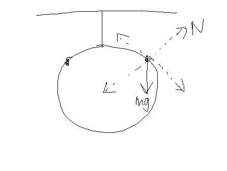

A ring of mass M hangs from a thread, and two beads of mass m slide on it without friction. The beads are released simultaneously from the top of the ring and slide down opposite sides. Show that the ring will start to rise if m > 3M/2, and find the angle at which this occurs.
F = ma
Kinetic/potential energy
The ring is supposed to rise when the Normal force overcomes the gravitational force on the ring, but how is the Normal force supposed to point directly upward? There is no component of the Normal force that goes up.

I've already found the KE/velocity: KE = mg*(R - Rcos(x)) and I can get the velocity from there. And I know the net force on the bead is N - mgcos(x) which is = m(v^2/R). But I don't know how to make any force diagram that will make the ring go vertically upwards.
You have two forces exerted by a bead: one related to its curved motion, which acts radially outward; another is due to its weight, acting vertically down. You can find the vertical component of the radial force; the horizontal components of the two beads' radial forces will cancel each other.
This is what I don't understand. If I decompose the Normal force and the gravitational force based on the axes I set up in my picture, there is a net force pointing southeast. So what cancels out here?

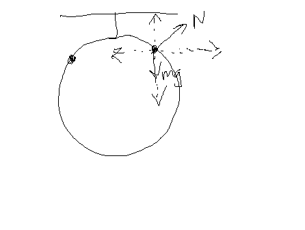

But then you would need to make a new set of axes:
But I don't think this would be of any help?

I don't know how to solve this without using forces. But the center of mass isn't moving but it would move vertically upwards if the Normal force pointing upwards was greater than the force of gravity
You have a radial force, at some angle from the vertical. You can surely project the force to the vertical and horizontal axes.
The radial force is the same thing as the normal force, or is it something different?
Not exactly. The centripetal acceleration is due to two forces: the reaction force (normal) and gravity. The radial component of this combined force is what I call the radial force (even though its direction is the same as that of the normal force).
The only force to decompose is the gravitational force, in which one component is parallel to the normal force radially, and the other component is tangential to the ring. I don't understand where this is going
Again, get the radial force first. That is easy to do, because all you need is the velocity and the radius, which you have. Then get the vertical component of this force, and subtract the force of gravity from it; this gives you the vertical component of the normal force, but mind the signs.

Again. The net force on the bead is the normal force plus its weight. This net force can be decomposed into two components: one radial and another tangential to the ring. The radial component of the net force (radial force for short) is responsible for the centripetal acceleration; this is the equation you have above. The other force is the tangential force, which you don't care about, because you can obtain the normal force from the equation for the radial force alone.
Thanks, TSny--I see what you mean. Facepalm.
Oh, so once I have the net radial force, I decompose that into its horizontal/vertical components? So it's like decomposing within decomposing or something similar?
Correct. Note the two beads will product twice the vertical component, while their horizontal components cancel - so all that remains is pure vertical force.
But this vertical force is on the beads from the ring, right? So it's pointing in the same direction as the gravitational force is initially pointing. Where are we going with this?
The radial force is due to the normal force AND the radial component of the weight. Given the radial force, you can obtain just the normal force (that's equation you got earlier). Find the vertical component of this normal force - that's what lifts the ring up.
