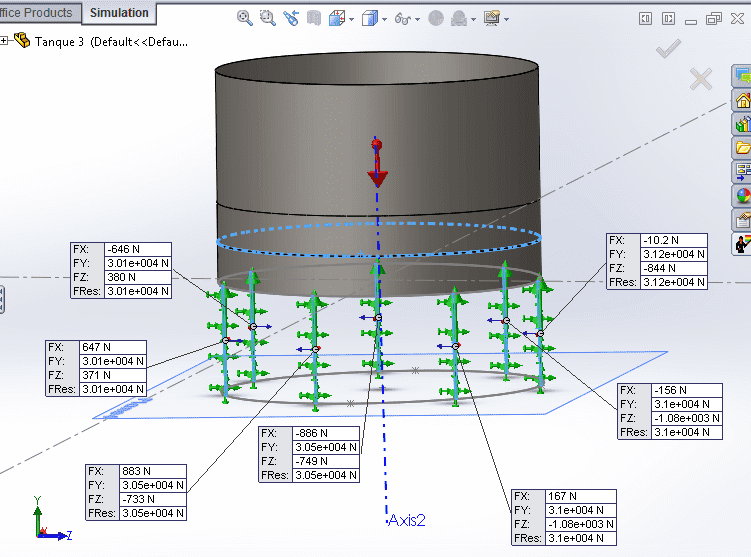

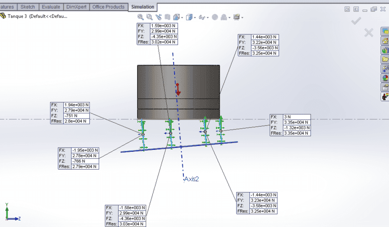

Well, as it turned out on a simulation, the tilt of the tank does not change much. For an inclination of 1%, on a tank of 20t, 8m diameter, 8m height and 7 jacks, the forces vary from 3.12e+004 N for the most charged jack to 3.01e+004 N for the least loaded. For 5% inclination, (which is huge!) the forces are respectively 3.35e+004 N and 2.8e+004 N. The model I tested is one of the highest tanks we would use with respect to the diameter. I attached the report images to this post.
I wonder thus if we need an inclinometer any more. Even 1º can be seen by the naked eye. And if the motors have an oversize factor of 3 to 5 (does not make any big price difference at this low HP), we don't have a risk of positive feedback either. The system would be stable.
The only risk is if one motor goes "out of (horizontal) line". Since the tank is quite rigid any acceleration would take on all the force. What about adding a rope segment between the chain hoists and the tank, for the elasticity to compensate any overweight ?
  • SolidWorks simulation render of a cylindrical tank on seven vertical jacks, with green and blue force arrows and callouts listing FX, FY, FZ and FResultant values at each support point.

  • SolidWorks simulation screenshot of a tank on seven jack supports, with force labels (FX, FY, FZ, FRes in N) at each support and the axis Axis2 drawn through the tank.
Looks good.
It should be possible for all other jacks to carry the unbalanced load if one jack fails catastrophically. That may require more than a factor of two in some situations.
