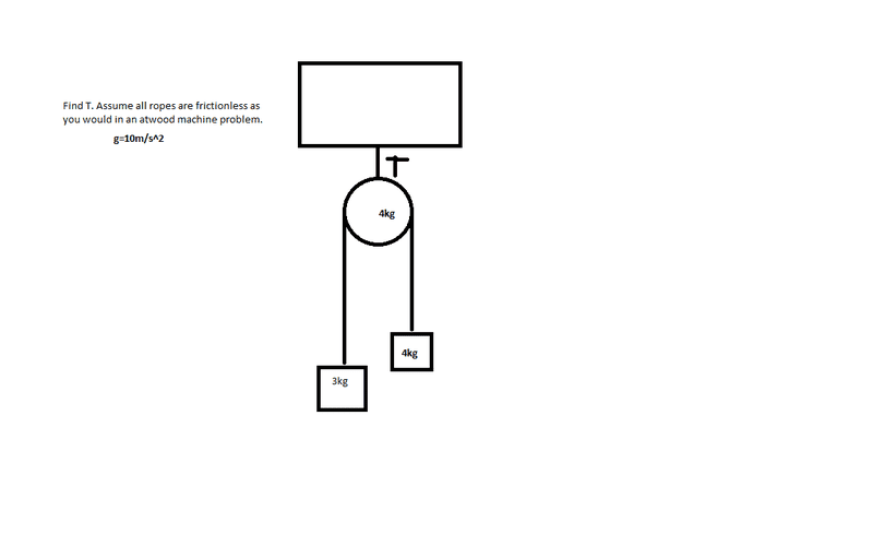

Tension in second rope between 3kg and 4kg abbreviated as = T2
40 - T2 = 4a
T2 - 30 = 3a
a = 10/7
T2 = 240/7
T = T2 + mg
T = 240/7 + 40 = 520/7

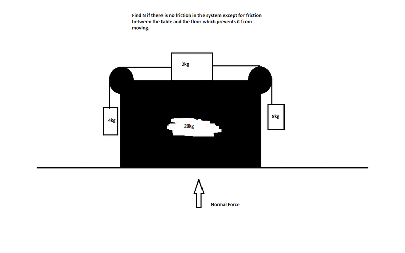

Problem 5:
Gravity Force exerted from 2kg mass and 20kg mass = 220N
Total Normal Force = Gravity Force + Net Force of 8kg mass = 220 + 40 = 260N
I feel as though my reasoning is far too simple to have gotten this one right.

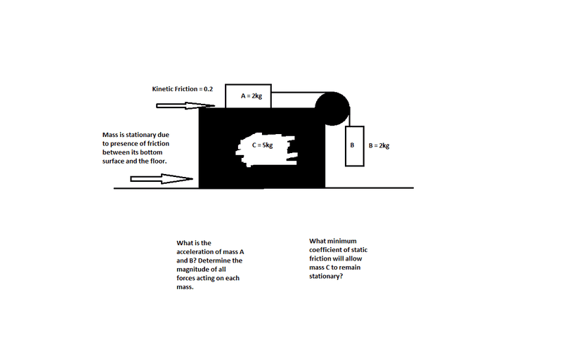

Problem 6:
Acceleration of mass A = Acceleration of mass B (downwards is considered negative in the case of mass B for convenience)
20 - T = 2a(B)
T - μ(k)m(A)g = 2a(A)
T - 4 = 2a(A)
16 = 4a
a(A and B) = 4m/s^s
T = 12N
(mass of C and A)g + [(mass of B)(g) - T] = Normal Force of system
70 + 20 - 12 = 78
(Normal Force system)μ(s) = (Normal Force of A on C)μ(k)
78μ(s) = 4
μ(s) = 0.5128

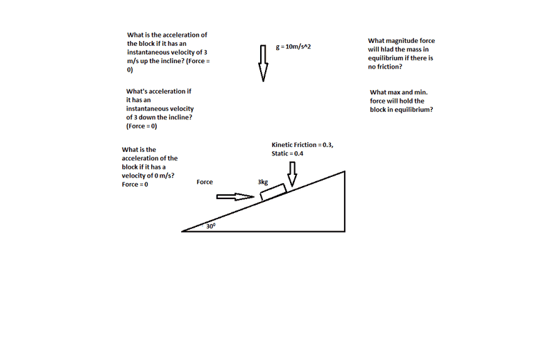

Problem 7: (a-c: force is not counted in problem yet)
a) Since it has velocity up the incline, the frictional force is added (helping) to mgsin30
30cos(30)(0.3) + 30sin(30) = 3a
a = 7.598
b) Velocity is down the incline, so frictional force is subtracted (opposing) from mgsin30
a = 2.402
c) Since there is no movement, frictional STATIC force is subtracted from mgsin30
a = 1.534
d) The resultant force that opposes mgsin30 in this case to keep the mass in equilibrium is F/cos30
Therefore, the actual force applied F = mgsin30cos30 = 12.99N
e) The minimum force to hold the block in equilibrium is WITH the help of friction to slow down the mgsin30, so
mgsin30 = F/cos30 + (0.4)30cos30
F = 3.99N
Maximum force is with friction OPPOSING to slow down Force applied, so
mgsin30 + 0.4(30cos30) = F/cos30
F = 21.99N

Problem 1:
40 - T2 = 4a
T2 - 30 = 3a
a = 10/7
T2 = 240/7
This is good.
T = T2 + mg
Two rope segments pull down on the upper 4kg mass.
Like I said, can anyone just tell me if I'm right or wrong?
It's ok if you don't tell me how I'm wrong, I want it that way.
This way, I can chance upon the answer myself.
Problem 1: You're wrong.
^^^ welp then, looks like a bunch of my other problems are wrong then
