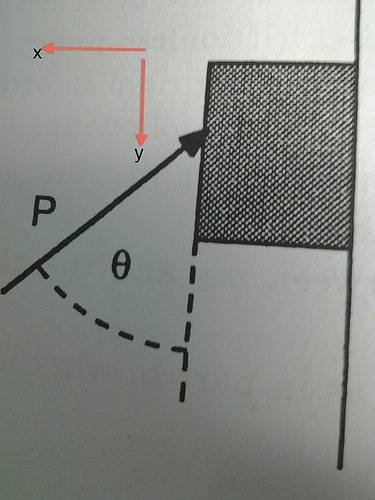

A block of mass 20 kg is pushed against a vertical surface (see picture). The coefficient of friction, μ, between the surface and the block is 0.2. If θ = 30°, what is the minimum magnitude of P to hold the block still?
Free-body diagram of a block pressed against a vertical wall by a force P at angle θ from the vertical, with x and y axes drawn in red at top left.

I drew a force body diagram and got equations for x and y.
x: N - Psinθ = 0
Y: -pcosθ + mg + f = may
N = psinθ
so f = μ psinθ
I put f = μ psinθ into the y equation
so i get
-pcosθ + mg + μpsinθ = may
I'm stuck here. I want to find P but I don't know the acceleration.
The problem states that the block is still, which would mean that ay = ?
The question asks:
Therefore the magnitude of the velocity is...?
The change in velocity is ...?
The acceleration is ...?
Why "minimum"? What kind of friction is this?
