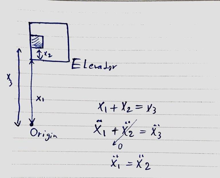

Hill said:
No. I consider ##a## having the same direction as ##g##. As the elevator accelerates downwards, ##a## is positive. When ##a=g##, the elevator free falls - both ##a## and ##g## are positive. When ##a \gt g##, the elevator accelerates downwards more than the free fall acceleration ##g##.
According to above picture... My friend was wrong and elevator's acceleration is same as block's acceleration...
MatinSAR said:
You did not go correctly from your second to the third line, but you got the idea. The accelerations need to be identical. Plug in the accelerations from the problem.
Yes!
Yes I see. The acceleration is "a".
