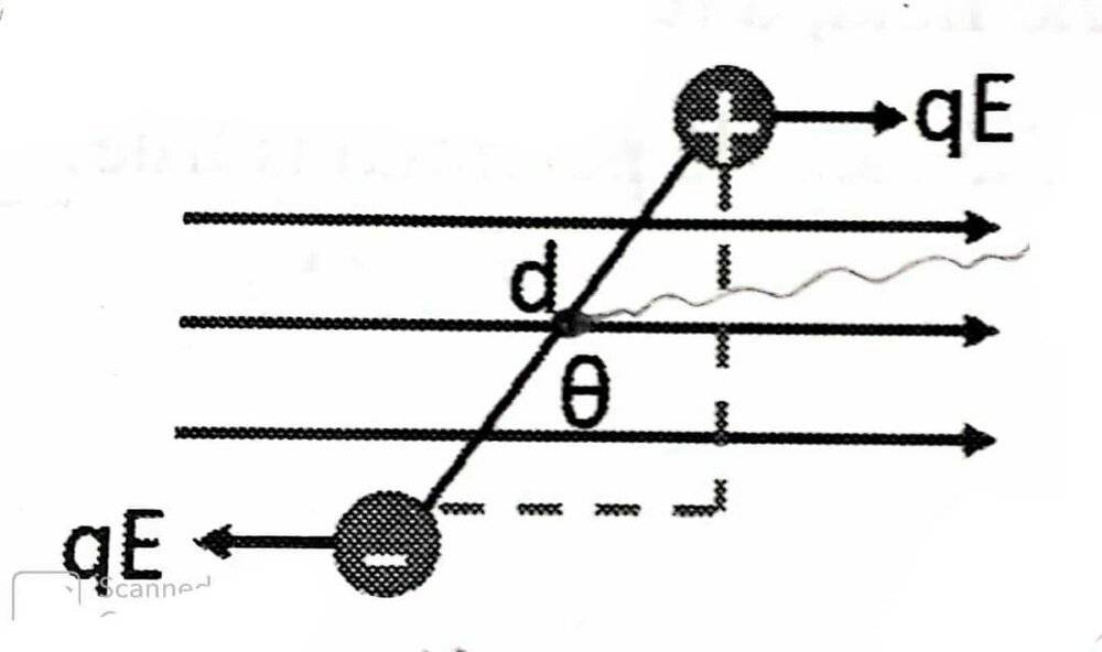

The force exerted by a uniform electric field on a dipole is:
A. parallel to the dipole moment
B. perpendicular to the dipole moment
C. parallel to the electric field
D. perpendicular to the electric field
E. none of the above
The answer is E.
F = qE
I think the answe should be C as shown in the attachment.
  • Diagram of an electric dipole tilted at angle θ in a uniform electric field of horizontal parallel arrows; positive charge at top right with force qE to the right, negative charge at bottom left with force qE to the left, separation labelled d.
C:The forces acting on charges are parallel to the electric field.
E:They add up to zero though torque acts on the dipole.
If you understand them you do not have to worry about the "right" answer.
