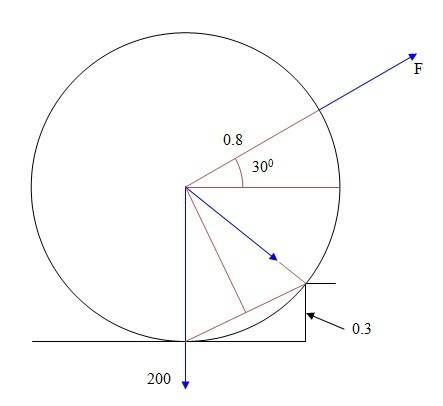

The cylinder with mass 200[kg] and radius 0.8[m] tries to climb a 0.3[m] high edge with a force F exerted at an angle of 300. what's the force and what's the minimum force for the cylinder to climb
Moments: F1L1=F2L2
The weight balances the the force, i made moments around the edge and got a true answer F=1670[N], but i don't understand the second question, about the minimum force, and it's about 766[N]
  • Free-body diagram of a cylinder against a 0.3 m step: radius 0.8 with 30 degree angle to force F, weight 200 pointing down, contact at edge.
"Minimal force" might mean the force needed if the angle can be adjusted. But then the two values should not be so different. Maybe you can adjust the point where it acts on as well. If that is the full problem statement and 766 N is the given answer, it is poorly written.
To get an answer so much lower, it must be allowed to apply the force further from the step.
Ah! Yes. That's how you can get about 766 N. o0)

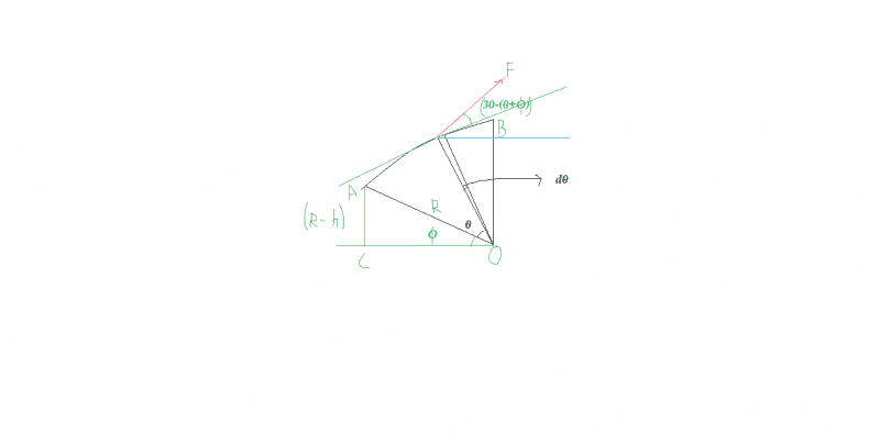

Hand-drawn diagram of a cylinder of radius R resting on a step edge at point A, with centre O, applied force F at an angle, and the angles theta, phi and (30-(theta+phi)) marked with an arrow showing dtheta.
The black curve shows the trajectory of the CoM. Angle ##\phi## can be found easily. Let the Com be at any arbitrary position such that it has rotated by angle ##\theta## about O.
Work done by F is ##\int _{ 0 }^{ (90-\phi ) }{ FRcos(30-(\theta +\phi ))d\theta } ##.
Just put the value in eq. (1). I think you will get the answers.:rolleyes:
Work is either torque times angular displacement of force times displacement and in both ways i get an other equation than: ##\int _{ 0 }^{ (90-\phi ) }{ FRcos(\theta +\phi )d\theta }##

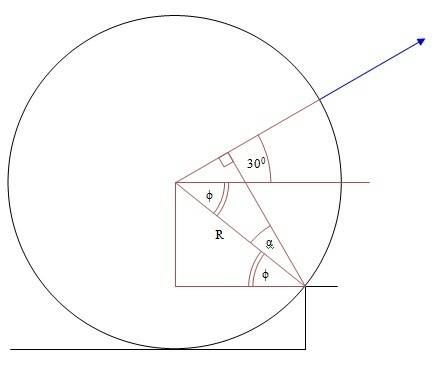

According to the new drawing, for the initial position: α=90-(30+Φ) so W=FR cos[90-(30+Φ)]
Of course we add θ for an arbitrary position and take an integral at the same boundaries
  • Geometry diagram of a circle with centre O and radius R, a horizontal line through the centre, a 90-degree right-angle mark, a 30-degree angle, and angles labelled phi and alpha; a blue arrow points up and to the right from the rim.

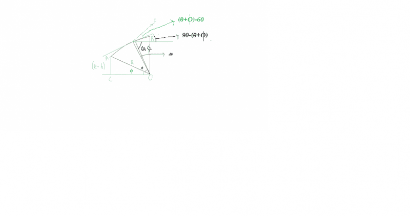

I made a mistake in #post 5.
The work done by F is ##\int _{ 0 }^{ (90-\phi ) }{ FRcos((\theta +\phi)-60 )d\theta }##
Handwritten geometry sketch of a cylinder resting against a step, with center O, radius R, height h, angles theta and phi marked, and green annotations giving force F directions at (theta + phi) - 60 and 90 - (theta + phi).
If you consider the AO as the initial condition and BO as the final condition you will find that initially ##\theta=0## and final ##\theta=90-\phi##.
What would you get after evaluating the integral?
