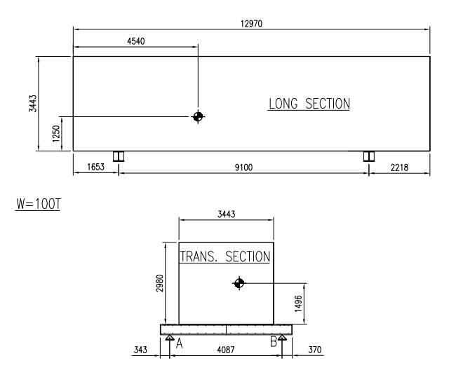

Hi Guys,
I am trying to calculate the load transferred on the beams and then to the four supports (two under each beam) from a cargo (in this case say a box) to be stored in a yard.
I have to check the suitable beam to be used and the load transferred to each support.
Thanks in advance. :)

I hope it works now...!

As you are probably discovering, this is a statically indeterminate problem. The loads depend upon the deflections, both in the beams and in the box. You can write a vertical sum of forces equal to zero and moments in each horizontal axis equal to zero, but that only gives you three equations.
Your options are ---
1) Do an FEA model;
2) Solve for force sums (e.g., the sum of the forces at the left end, rather than taking them individually)
3) Make a group of guesses that satisfy the three equations.
For most engineering purposes, a combination of 2) and 3) will be sufficient. If you want to get very precise, go with 1).
