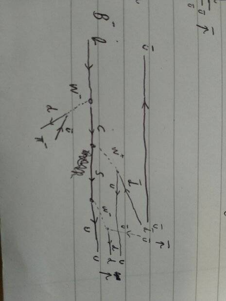

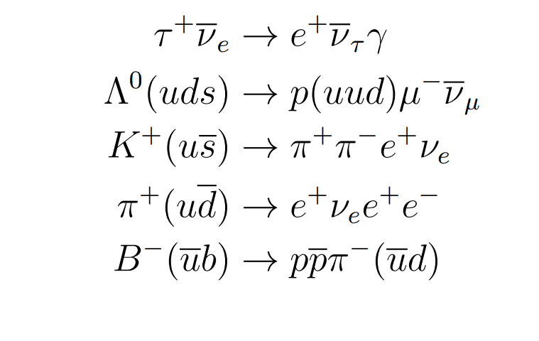

Find the feynman diagrams for the following reactions (image)
None
The first two went fine, but i got stuck at the third one and the rest. For the third: I had that the up quark remains the same as one is needed in a pion and that the anti-strange forms an anti-down and strange. But first, I dont know really why that exactly would be the case. Secondly I dont know where the other particles would be coming from. Can you help me?
Consider what the incoming and outgoing particles are and what vertices could possibly convert the incoming particles to the outgoing ones. Also be careful to satisfy conservation laws.
An anti-strange forming an anti-down and a strange would violate Lorentz invariance, so that is already a big no-no.
In the outgoing particles you have (after writing out the quark content): ##u\bar d \bar u d e^+ \nu_e##. There is no strange here so it seems strange (pun intended) to convert anything to an anti-strange. However, you should note that there are no strange quarks in the out state! So where did the strange quark go? What vertex could possibly violate strangeness? (Or quark flavour in general ...)

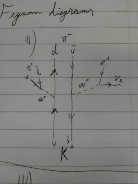

Oh sorry that was a typo, i meant anti-strange -> anti-down and up via weak interaction.
I now have this (sorry for bad quality, i ran out of paper), which feels ok? But I mostly googled possible antistrange decays to find this and dont know how to inuitively find that exact this happens. I do now understand why more quarks spring, this is because of the large mass difference between strange and up. EDIT: I see the errors in the arrow directions.
I have written down what I could interpret from your diagram with some additional annotation:
Charges are noted in red. As you can see, your diagram violates charge conservation and has the incorrect outgoing quark content. It also has two weak gauge bosons. These are very massive and will generally lead to suppressed amplitudes. You should consider if both are necessary to do what you want to do.

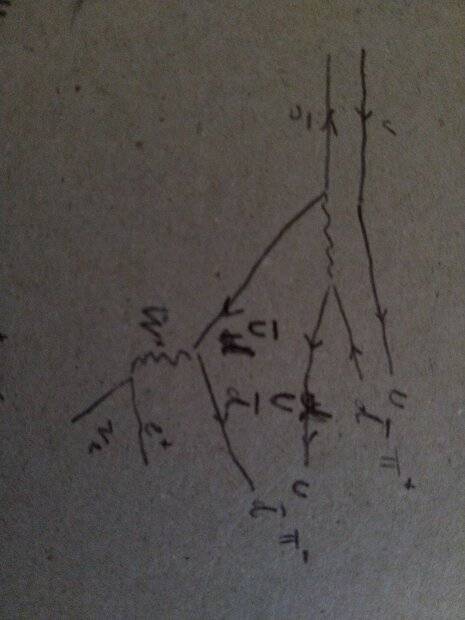

I think i get it now. Are these correct? EDIT: i do have quite a lot of W bosons, but I think with so much you would not get the amount of quarks needed.

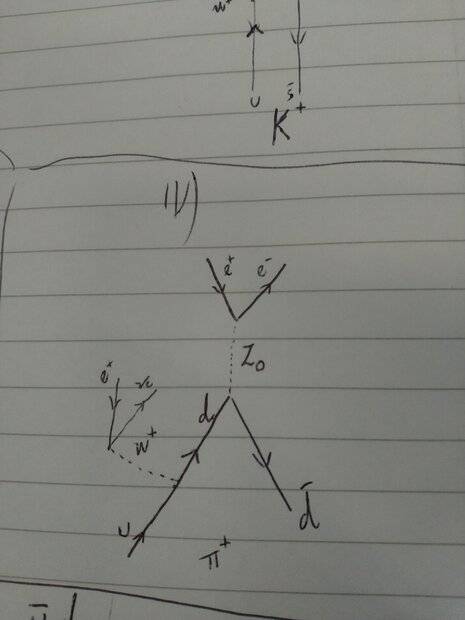

Here is the last one. I would like to add by the wayy, that the exercise is focused on weak interaction.
It is a weak process as it involves flavour change (the strangeness in the in and out states are different). However, that does not mean that there is only Ws or Zs, only that there is at least one.
In this case, the leading contribution will have only one W. Try to find it!
