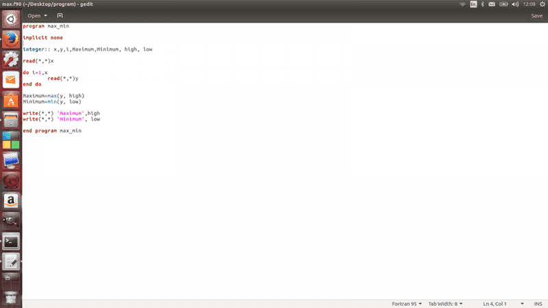

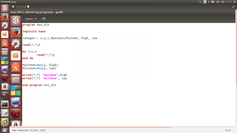

Hi guys, I am playing around with different functions on Fortran 90. I tried to create a simply program that would take five number that I select in a do loop and write to the screen the Max number in that list and the min number in the list. My code is below along with my output:
what I cannot understand is what is going wrong, my maximum is coming out at 0 and my minimum is coming out to be
32749, what dose these number represent? why is my output coming out like this? and advice would be great.

Your variable 'high' is not initialized and never updated. Idem 'low'
Hint: after you have looked at the first number in the list, before looking at the other ones, what are the largest and smallest numbers at that point?

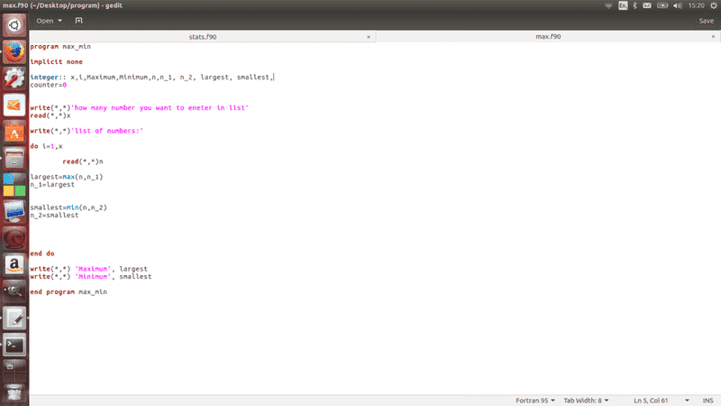

Ah thanks guys, after about 30 min or so I managed to re-write the code. As shown below.
Is my inution on how this program works correct: Once in the do loop and I have selected my list of numbers I the set a varibale highest equal to my max function, now this is how i see the max function working. The n part will read all the values in the list, it will the assign the max/highest value to n1, now n1 has a new value I the set n1 equal to highest and output that to the screen is this correct??
ignoring my top code. I have now corrected it. The code look as follows.
Not good. n_1 and n_2 are not intialized. If your Fortran environment is decent enough to initialize all variables to zero before beginning, n_2 stays at zero, even if you enter e.g. 10 as the lowest number.
And if n_1 (like the variable low in your post #1) starts off at a big number, that will remain the maximum (unless you enter a bigger number).
@BvU is driving at the key problem in your code. Let me try to point out a more cosmetic issue.
You write, for instance:
Code:
largest = max(n,n_1)
n1 = largest
It would be much clearer if you wrote instead:
Code:
largest = max(n,largest)
In an assignment statement, the first thing that happens is that the right hand side is evaluated. After that is done, the resulting value is placed in the variable in the left hand side. There is no problem using the same variable on both right and left hand sides.
Please post your code as text rather than as a screen shot. As a screen shot, we can't copy and paste individual parts of your code -- we have to type it in ourselves.
Also, use code tags, which preserve indentation you are using.
