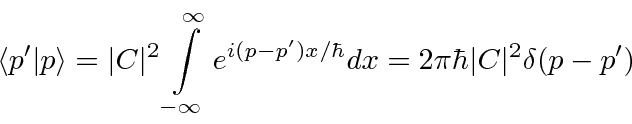

I think I got it.
The eigenfunctions of momentum operator are obtained by solving:
[tex]-i\hbar \frac{\partial}{\partial x} u_p = p u_p[/tex]
[tex]u_p = C exp(-i\frac{p}{\hbar}x)[/tex]
To normalize, we say ##\langle p|p\rangle = 1##.
Therefore ##u_p = \frac{1}{\sqrt{2\pi \hbar}}exp(i\frac{p}{\hbar}x) = \frac{1}{\sqrt{2\pi \hbar}} cos (\frac{p}{\hbar}x)##. Simply by comparing we deduce ##k = \frac{p}{\hbar}##.
Thus the wavefunction given is in a state that's the superposition of ##\hbar k## and ##2\hbar k## states.
This implies that the possible momenta are ##\hbar k## and ##2\hbar k##.
Equal probabilities of getting either.
Energy is found by using ##E_1 = \frac{p^2}{2m}## or ##E_2 = \frac{4p^2}{2m}##
You can't jump from the exponential to the cosine willy-nilly like that. What happened to the imaginary part? Do you think it's OK to through it away without an explanation?

Think more carefully about what dauto said. You seem to have missed the possibility that p could be either +ve or -ve. You need a linear combination of your basic ##u_p## eigenstates to get each cos function in ##\psi(x)##.

The wave function is nether an observable nor an eigenvalue. You can't just drop the imaginary part. Try expressing the cosine as a combination of exponential functions.
dauto said:
You meant to say that the eigenvalue of an observable is real.
The cosine is ##\frac{1}{2}\left(u_{p} + u_{-p}\right)##. Combination of forward and backward momentum
